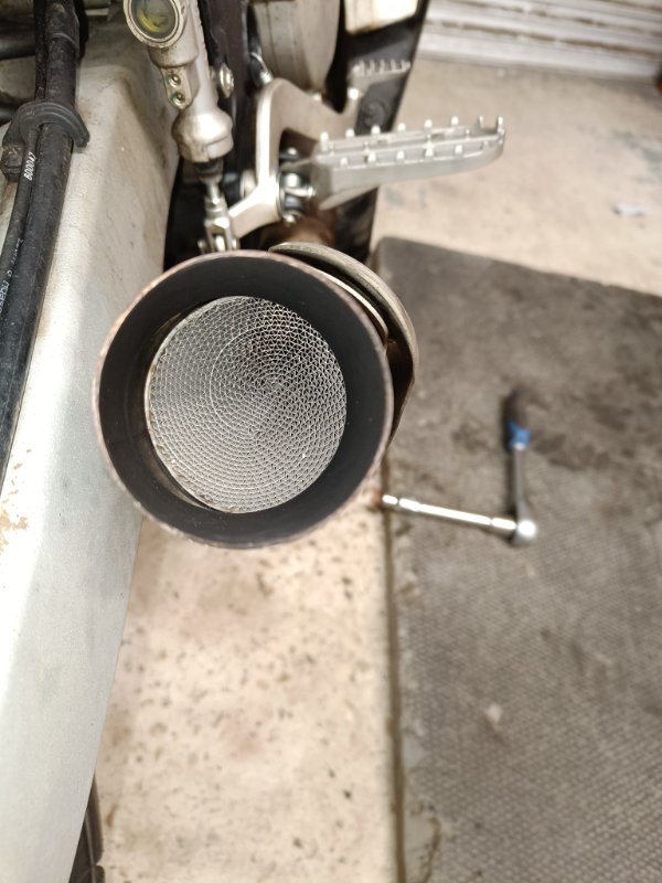

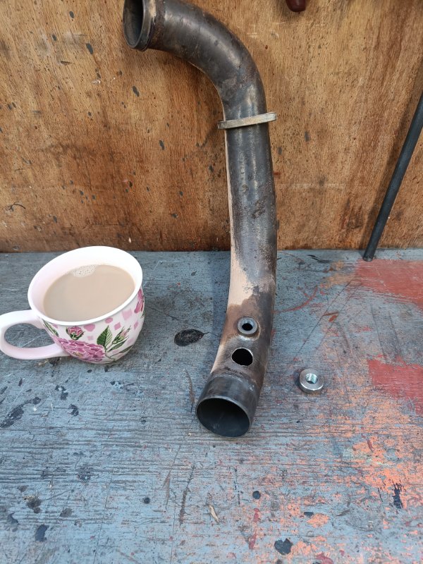

Afr probe welded in place so I can read in real time what the fuelling is doing,
Just waiting on some parts to alter cat removal and straight through exhaust (with db reducer),+4 degrees flywheel adjustment race ECU,many things to try in the coming weeks,
