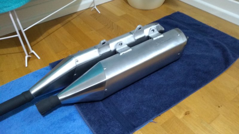

Stripped the exhaust off the WK400 to give them a refurbish, thought about modifying it to a single pipe but the original still has plenty of life in it once cleaned up
Stripped the rust and paint off the header pipe and tubes to the mufflers ready for 3 coats of heat proof black. 8-)
The plan was to repaint the mufflers in satin black but decided on the semi polished aluminium look,............... lots of brass wire wheels, dust, 1200 grit wet n dry and aluminium polish later :o

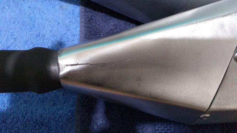

One of the muffler's has a small fracture but put some JB weld in it for the time being as it's not that bad.......don't sell yours you will miss the challenge :lol:

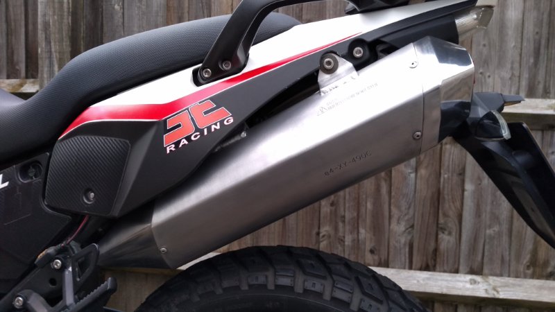

Well the sun came out this afternoon and armed with a brew in hand set about reinstalling the exhaust system, new gaskets as well :mrgreen:
Very pleased with the look :D ..........roll on the day we can all go out for a ride :(

netsonic wrote:Well the sun came out this afternoon and armed with a brew in hand set about reinstalling the exhaust system, new gaskets as well :mrgreen:
That makes a huge difference to the looks. Image
