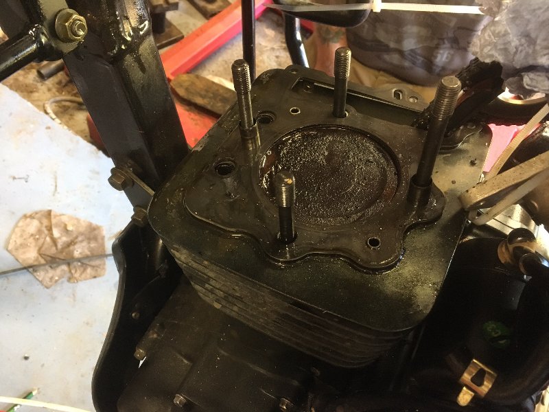

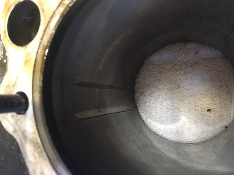

Very sorry to all the guys that gave advice for my late reply about my smoking WK
I have been watching the forum with interest!
We stripped the bike yesterday and found to my horror that the gudgeon pin had come loose, either the circlip failed or it wasn’t installed properly and the pin moved causing massive damage to the cylinder wall. Before posting on here, I decided to speak to WK bikes and see if they would at least honour the warranty on the parts, as it was obviously a fault from manufacture/build. The bike is less than a year old and done 1,800 miles. But as you can probably guess they didn’t entertain it as I wasn’t the first owner. After a lot of time I managed to get 10% off, but anyone reading this and thinking of buying a WK bike, I would really consider the lack of warranty, if you are unlucky and need it. On the upside the parts are cheap and everything came to less than £170, new block, piston, rings, gaskets, pin and circlips etc.
So the parts will arrive next week and hopefully I can get back on the road again.
Also, my dip beam lights have stopped working, anyone else had this issue and know the remedy? I changed the bulbs but no difference – full beam still works.
Thanks
Phil
Thanks
Phil

Wow , that would make it smoke a bit !
Suspect you'll find the headlight switch has failed and you're not getting any supply . Think Glenn G fitted a Cagiva switch which looks the same but is better quality .
