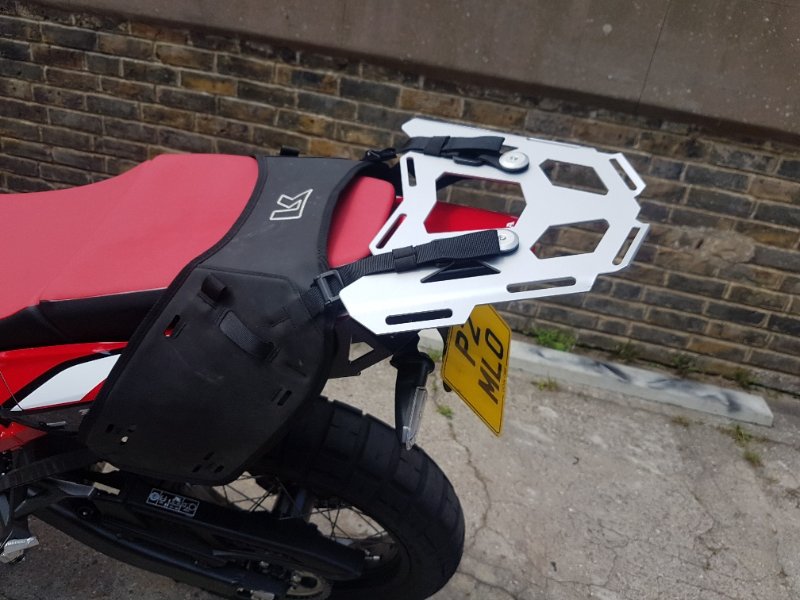

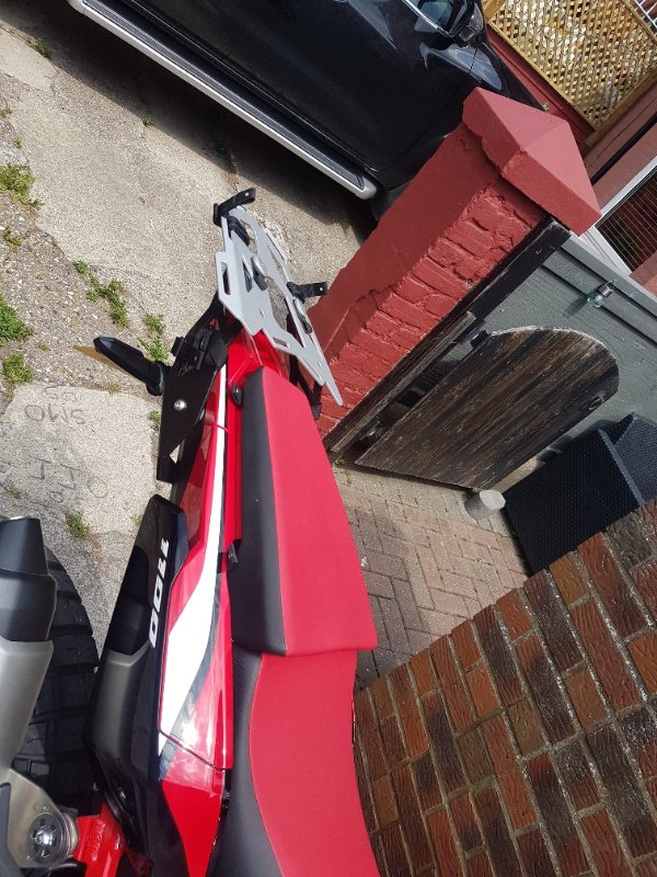

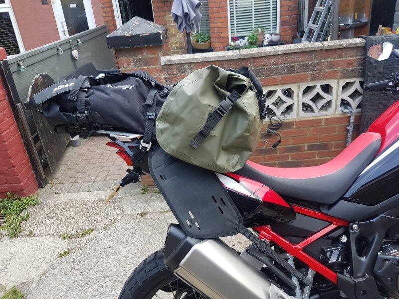

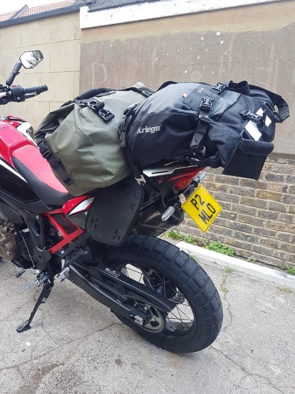

Just a quick look at how i did my Luggage options again but on the 2020 Africa twin , I have used this set up before and although its a bit Heath Robinson it works and withstands the rigors of offroad , so i brought a Touretech aftermarket rack for the AT and it is very well made and fits perfect , the only thing was that the support s made in steel turned up just bare metal , so i gave them a spray ,
should of had them powder coated , then i had the kriega OS mounts and base
just used the two last fixing holes and attached the mounts , once fitted the straps pull tight and you have a very stable platform for 12 or 18 kriega os bags ,
then using kriega straps i use my US 30 on the rack , and Givi dry bag on the saddle
very light and could be used on various bikes , , the exhaust just clears
