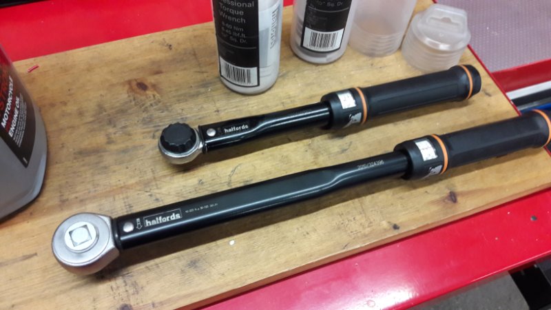

I've 2 Halfords wrenches, a 3/8" drive which measures 8-60 Nm and a 1/2" drive which does 40-200 Nm. They seem well made and robust, far more so than cheaper previous wrenches from Machine Mart. Both came with comprehensive calibration certification. For less than 8Nm I still rely on feel/intuition albeit I keep on meaning to get a low torque 1/4" drive wrench.
The Halfords wrenches aren't the cheapest and I can well believe they are/were made by Norbar, as mentioned above. I've had them around 15 yrs now so getting the calibration re-checked is on the to-do list.
