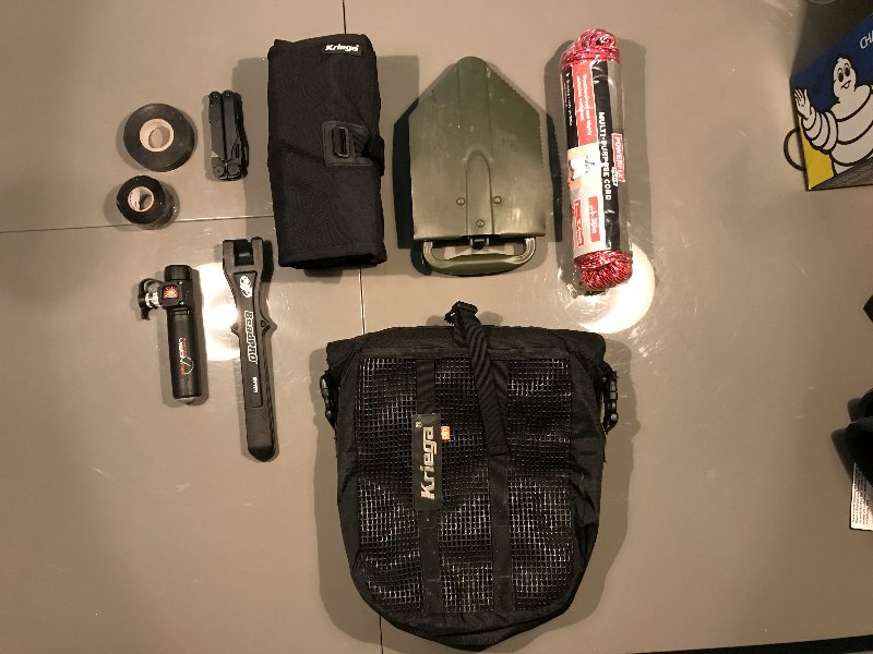

Toolkit

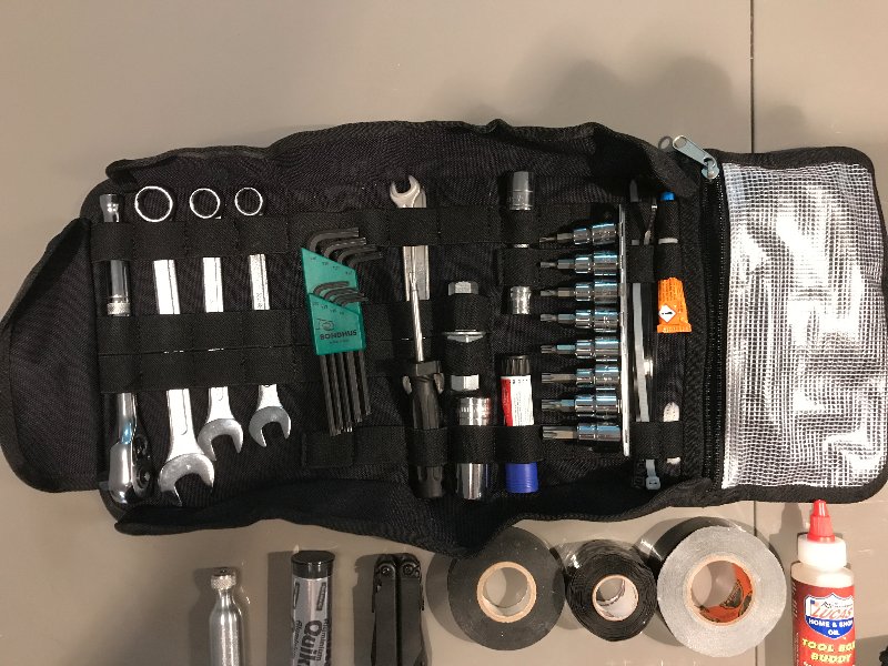

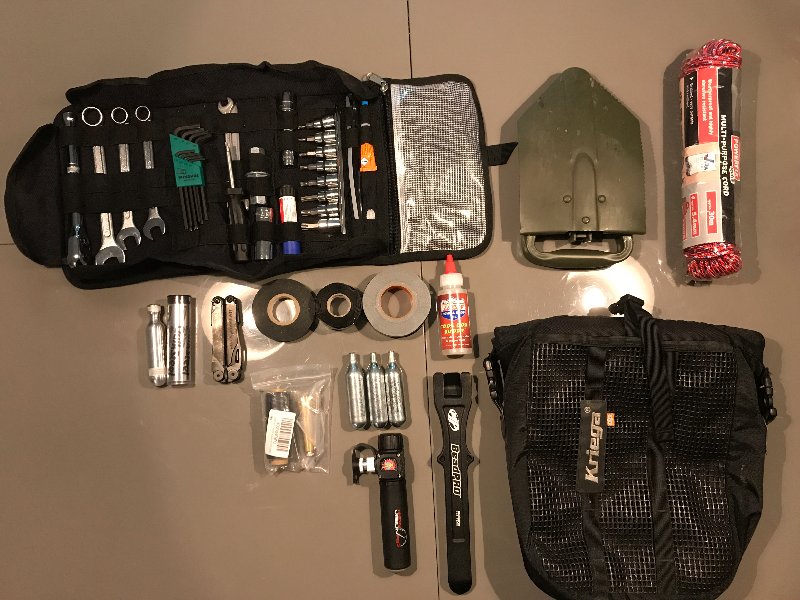

I’ll start with the toolkit because this is the most thought through. It needed to be since my mechanical experience is currently lacking. The toolkit has taken a while to put together. I think it strikes the right balance of being able to get myself out of basic/common scenarios whilst still travelling light. The whole thing fits in a Kreiga US-05.
  • Kreiga Tool Roll
  • 3/8 Ratchet with extension
  • Ring Spanners 17, 14, 13.
  • Hex Bits: 17, 13
  • Various Torx keys T40-T9
  • Various Torx bits T50-T10
  • Toolkit from under passenger seat: 8mm, 14mm spanner, screwdriver + oil cap removal tool
  • Axle removal tool
  • Loctite Blue
  • Various tie wraps
  • Super glue
  • Dynaplug Pro tubeless tyre repair kit
  • QuikSteel
  • Leatherman Wave
  • Sewing Awl
  • Gorilla Tape
  • Electrical Tape
  • Motion Pro Nitro Tape
  • Generic Lube/Oil (Lucas Oil Tool Box Buddy)
  • Hand/CO2 pump with 3x CO2 bulbs
  • Motion Pro Bead Prop bead breakers / tyre levers
  • Foldable Shovel
  • Multi-Purpose Cord / Tow Rope
There seems to be a bit of duplication with the torx/hex/spanners and possibly tape. Perhaps I’ll cut it down further to remove this duplication.

Shovel :geek:

get rid of the shovel and take a tube

You don't need to bury your shit in Spain, the flies and ants will have reduced it to nothing quicker than you can cook a paella

Bin the shovel,the electrical tape,the motion pro tape and the tool roll.take a mountain bike pump instead of the co2 canisters,wrap what's left in a micro fibre cloth and stuff it in the kriega bag with a spare tube.

We all learn by our mistakes and experiences , yes the shovel needs to go but if you feel you need any of the other stuff and can carry it , take it !!!

Haha, I guess its unanimous on the shovel then. Consider it gone.

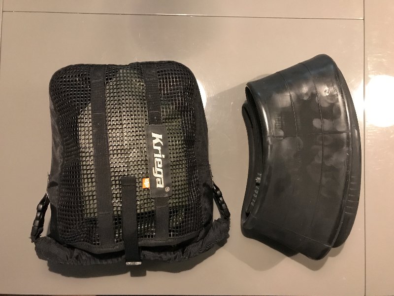

Inner Tube
I was in two minds about the necessity of tyre levers and inner tube but I guess a torn sidewall is not beyond the realms of possibility and whilst expensive, the tyre levers can be considered a long-term investment. I’m toying with getting an air compressor too but surely a couple of CO2 bulbs and a hand pump will be sufficient for 2 weeks.
The plan was to go for a UHD 18” inner tube. I’ve read in various places that this should suffice for both wheels as last resort although there are potential problems with off-centre valves. I’ll have changed one tubeless tyre by the time I start this trip and have no experience messing about with inner tubes, valves, valve stems and valve stem removal tools. As much as I’m keen to learn more about that stuff I’m hoping not to have to do so alone on the trail.
However, the UHD 18” inner tube has arrived today and it’s absolutely massive, so big that I don’t think I’ll have the room to carry it securely. Naively I had a picture of a bicycle inner tube in my mind!
Would a not-so-UHD tube + puncture repair kit be considerably smaller in size?

I take it the bike has tubeless tyres? If so then don't carry a ultra heavy duty tube. Those things are massive. In the event you suffer a puncture too large to plug then a normal tube will get you back to town. Those sets of three mini levers are fine on the trail but you will most likely need to use the stand to break the bead on the tyre/wheel. CO2 canisters are not much cop. One is enough for a bicycle tyre so three will not inflate a motorbike tyre. I carry three of the bigger type and a mini pump. They are quite small and work ok but are slow. When trail riding in the past I used to just carry a full size bicycle hand pump. They work surprisingly quickly when infatting an enduro tyre.
