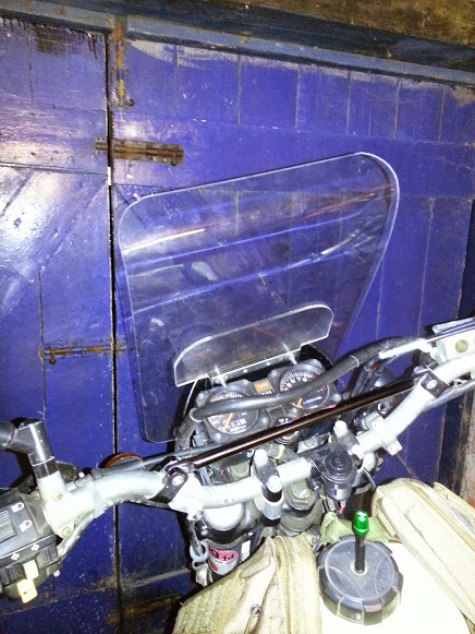

Just as my first attempt melted in the oven I was hit with the inspiration for this design.
I started with a cardboard template.
Happy with it.
Once I made it with the real thing I realised it was a bit flimsy.
As I had a smaller bit I made a reinforcing plate.
I used five bolts as I only had five bolts.
Flushed with success I heated it (gently this time) and belt it out as it was a bit near my face.
I will test it on the ride down to Salisbury on Friday :)

That looks great and will keep loads of wind of you

Thanks, I just hope it doesn't bend too much, if it does I'll have to make it shorter. I feel quite lucky that it went so well.

Looks good, If you or anyone plays with perspex it type stuff,
Stick it in the oven, (make sure the wifes out ;)) About 100-130 degrees. It`ll become floppy, like a thick pancake.
Its then possible to form it quite a bit.

I tried that with the prototype but my oven isn't very good at detecting its own temperature...

Always interesting to see what you'll do for your bike next. Screen looks really practical and relatively cheap to make.

pinball1008 wrote:Always interesting to see what you'll do for your bike next. Screen looks really practical and relatively cheap to make.

The screen worked perfectly right up to 75mph (top speed on current front cog). Only downside is that when I go under low branches I hit the peak of my helmet on it. I just have to remeber to lean back.
