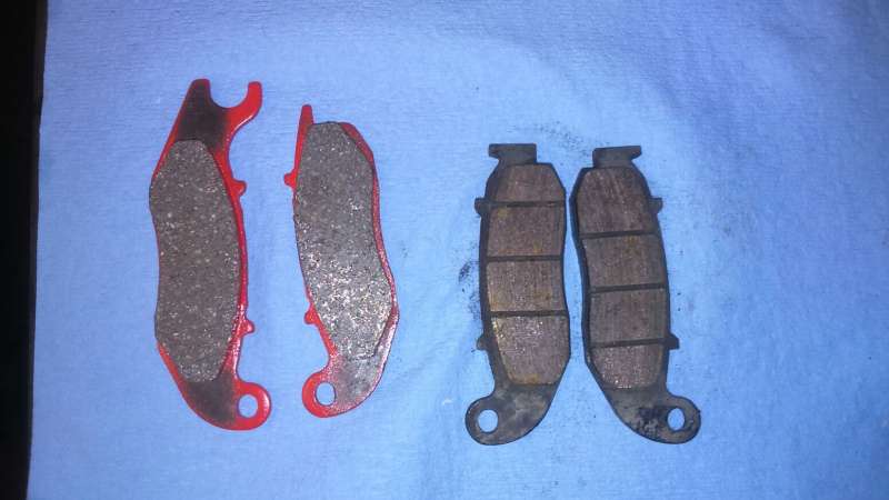

So dropped the pads out today to check shape and they are as mac10biker shows in his picture. Attached my picture to show they are the same. Not many options to replace and the EBC FA664 look correct only available in organic so will be very interested when mac10biker reports back on how the pads perform against stock

Well done on sorting pads out guys, I can also confirm fa465 are not coreect as mate Roy tried them and see for yourself difference
Anyone know contact at Ebc to get them to change their website as its wrong

Interestingly Andi, yes CD F544 is on the back of the stock pads so they look correct.

Spoke to Jon at EBC last week and they have already published their 2017 catalogue and the WK is listed wrongly (think it says FA465R). I am going to email him next week with the rear and will post here and let everyone know.
