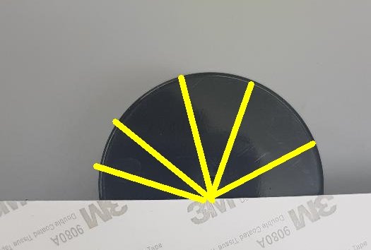

Mine has done 23000kms issue free.
The lower steering head bearing is vulnerable to water ingress, especially during washing or riding in heavy rain. A black aerosol paint can top makes for an excellent protector. Just cut it to size, loosen 4 mudguard bolts slip one end under and tighten bolts again. The curve of the plastic top fits the steering stop perfectly. Cheap and easy insurance for longer steering head bearing life.
Here is your standard spray can top. Now cut it in half and then cut radially from the centre out, like this. Loosen the 4 bolts that hold the top mudguard about 10mm/0.5'. Now you mount your "very professional rain shield" upside down. Slip those triangular "fingers" you cut between the guard and the bottom of the T-stem while flattening the curve of the cap. It slips in easily and sits there naturally. Tighten those four bolts and your done. Looks pretty OEM when done and I always seem to end up with more black caps than spray cans. One less now and put to good use.

Great idea. You can also use what is called a Nilos seal below the bottom taper roller bearing which does a better job of sealing than the original washer. I took mine apart and drilled the headstock of the frame tapped it M6 and put in a grease nipple so i could fill the void with good quality marine waterproof grease. The Indians didn,t seem to like greasing either the suspension or swinging arm bearings either. I don,t think this is a problem just with Royal Enfield though as nearly every bike i have bought in the last 20 years is the same.
