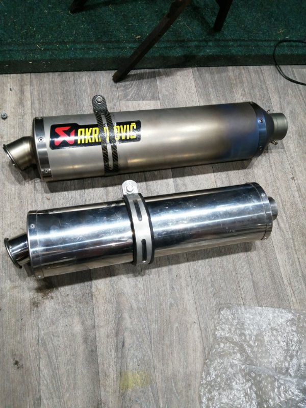

Looking good so far, the later 640s were a good base bike, I never liked the look of the Adventure but it served a purpose and did it well.
I'm also thinking the Akra is too long, can you shorten the link pipe rather than the can? That'll help keep your ears from bleeding on a long day.

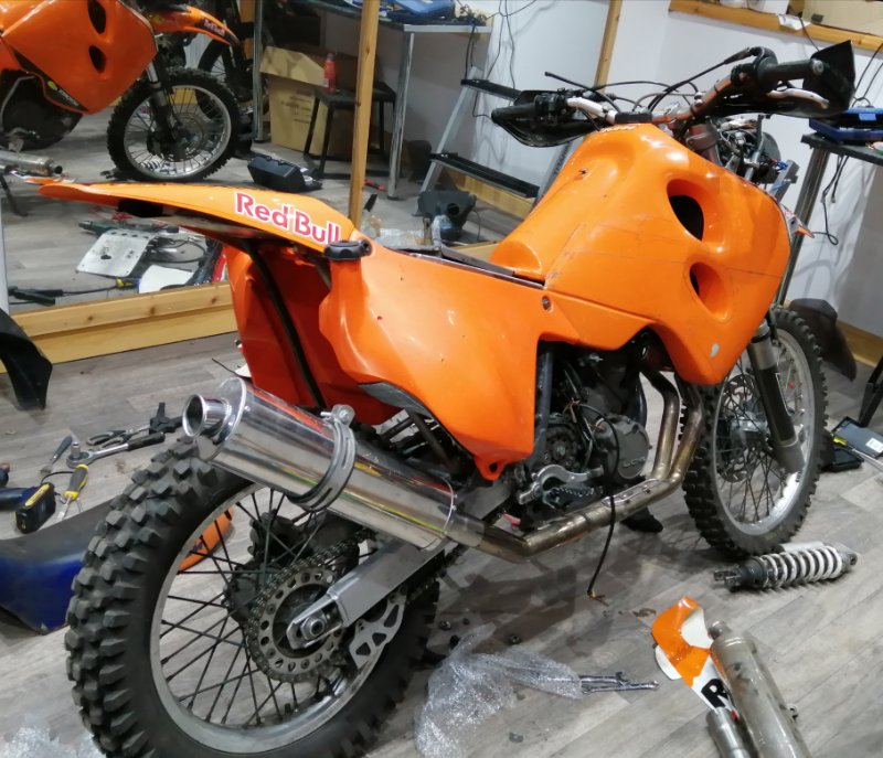

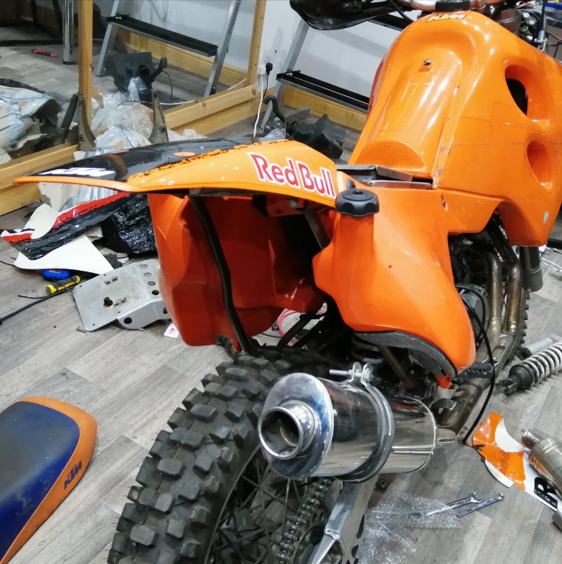

bowber wrote: Mon Jun 15, 2020 5:41 pm Looking good so far, the later 640s were a good base bike, I never liked the look of the Adventure but it served a purpose and did it well.
Steve
Gone with plan B, the akrapovic adapter was to large and short, I had this in the garage so will fit it on. I will weld a bracket from frame to hold bracket on Can.
It is a unknown make no stamps, think best to fit something and get it on the road and at a later date once all teething problems getting ironed out will ride it to a exhaust builder to fab up a link pipe to a better end can I will supply like the ones mentioned on previous posts.

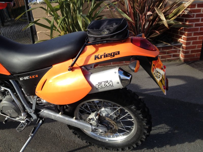

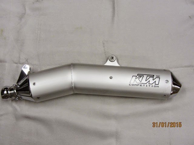

I fitted one of these to my 640 Enduro
KTM02Silencer (Small)[1].JPG (35.01 KiB) Viewed 3612 times
Coupled with a FCR 39 Flat Sided Carb, transformed the off road performance
Time knows no limits for days such as these.............

IanB wrote: Mon Jun 15, 2020 10:38 pm I fitted one of these to my 640 Enduro
Yes I looked at 640 cans but they are left sided and my pipes right sided, would have been ideal as actual design for the bike.

Post by IanB »
WesleyDRZ400 wrote: Mon Jun 15, 2020 10:43 pm
Would fitting the 640 Enduro front pipes take the exhaust across to the left hand side and allow the L/H silencer fit ?
