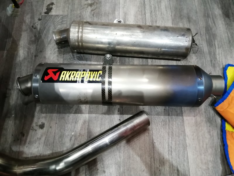

So I am waiting for the exhaust connector adaptors to arrive. I have a 50mm pipe I will cut to required size as connect.
See the exhaust that was fitted compared to the proposed option.

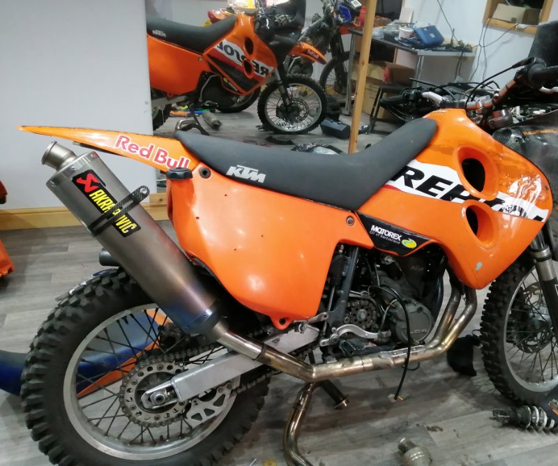

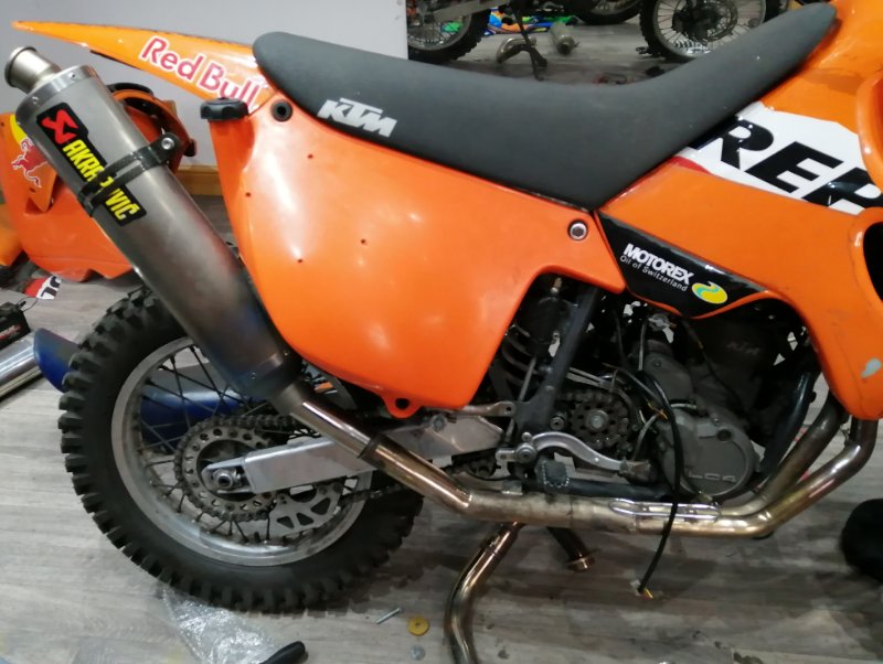

What do you guys think?
To long should I attempt to cut the can down abit or its OK.
It's just a rough idea of location as will cut the pipe with bend to fit with joint connections
The connecting pipe is long which I need to cut so if I cut the silencer down in size it will still be high up which looks better I think

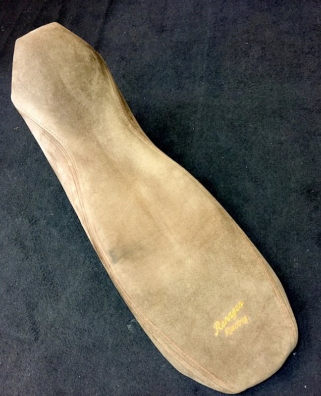

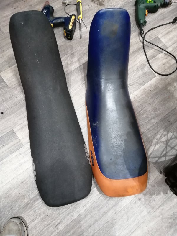

What about the seat?
I'm thinking to buy some white suede material and make something swanky like this
I could just take this seat cover off (right one) and follow the lines and cut out the sections then get professional stitched and refit

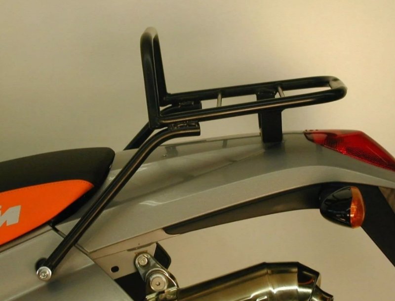

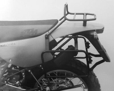

Luggage rack ideas?
Well on sump gaurd will be a small box for basic tools small repair items.
I will be using soft luggage l, I think the side tanks will act as side racks and I can secure the soft luggage I will be using to straps like magadans use but also on the lower subframe brackets the side tanks attach to.
So I will need a rear rack..... I'm thinking something like below, I understand its not low profile and its all about weight down low but I won't be fitting anything on top just utilising the rack for the luggage rack straps to run under and be retained.
I like it that it acts as a handle should you need to man handle the bike if stuck in mud, pushing in a river crossing ect ect. Even walking around the bike with stand off can utilise it as handle.
I will offcourse need to adapt it as front brackets will need pushing out .. And spray in white to match the orange white look I'm going for :roll:
(not side racks in photo)
s-l400 (3).jpg (19.99 KiB) Viewed 2839 times

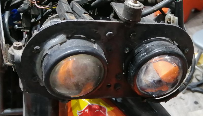

Lights
Will fit some form of auxiliary light to front as good lighting is required for a adventure style bike however will keep standard headlights, as you can see the 1997 620 egs adventure has different headlights compared to 640 adventure
Ktm 640 adventure
My 620 EGS Adventure
Indicators..... I'm thinking to just not fit them, in UK it's fine but what about Europe ect ect...... Would it cause problems not to fit them?
Rear light..... I'm thinking old school look like original 660 rally, where can I get these lights?
Luggage rack will be fab to fit just above as required space dictates

Re. the exhaust, which is the only part I feel in any way qualified to comment on having fitted hundreds of slip ons and full systems to race bikes and sports bikes... Is that really the correct can from Akra for a KTM640? It looks huge, and looks to me more like the one they used to make in the 2000s for R1s, Fireblades, GSXR1000 etc. You could cut it down, but maybe something slim and much shorter like Racefit do would suit the bike better?
https://www.speedycom.co.uk/other-perfo ... -exhausts/
