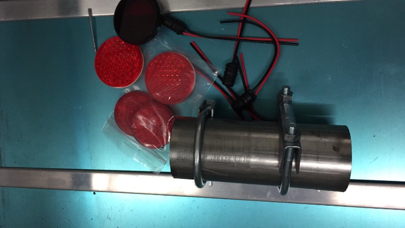

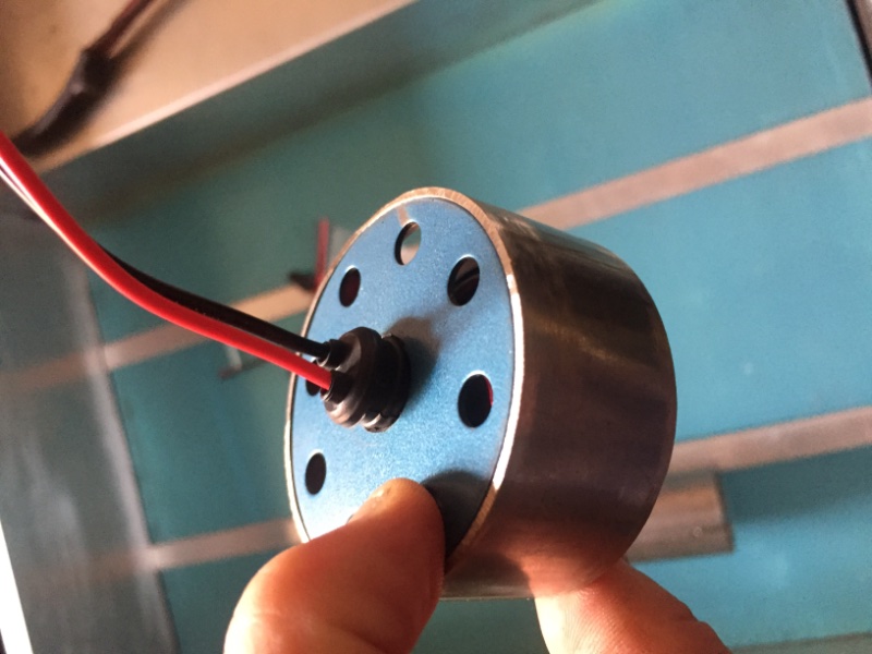

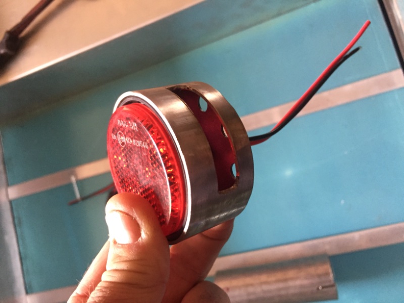

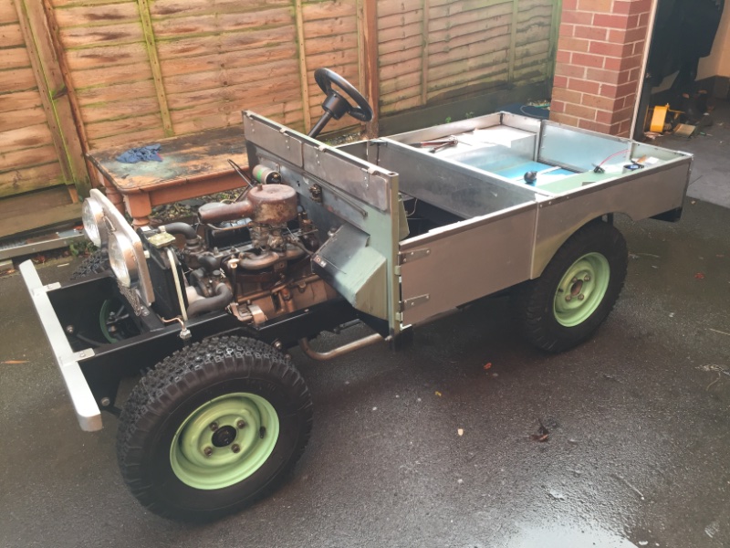

Starting to look all ok now, i made the rear lights out of a section of stainless exhaust pipe and some bicycle reflectors. The seal that the reflector sits in is some front fork seals of a XT660R, its a perfect fit and the slot is for the number plate light

Im getting close to nearly done bar the wings and bonnet. Then it will be stripped apart again to make good anything not quite right and then painted.
I have no idea how im gonna do the front wings as the corner part is too hard for me and gonna need some help. Anyone you know with an english wheel in the Bristol area??
