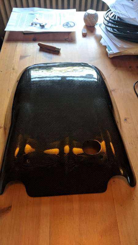

This little beauty arrived from Chris AKA Catcitrus. It looks great and has filled the lounge with that classic resin smell :D
It's weird that that the shiniest, fanciest bit of my bike will be that bit that gets all the grief!
