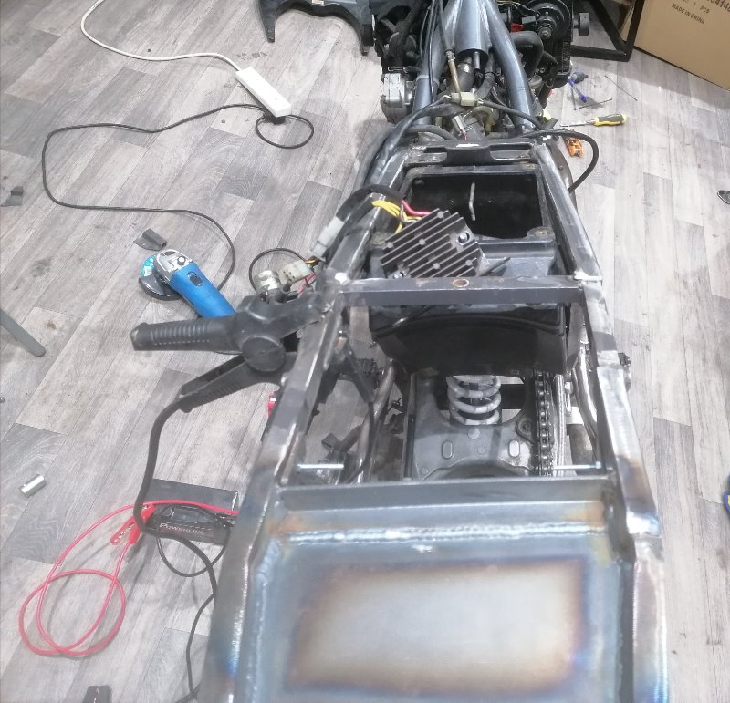

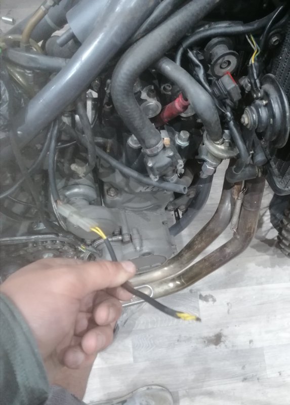

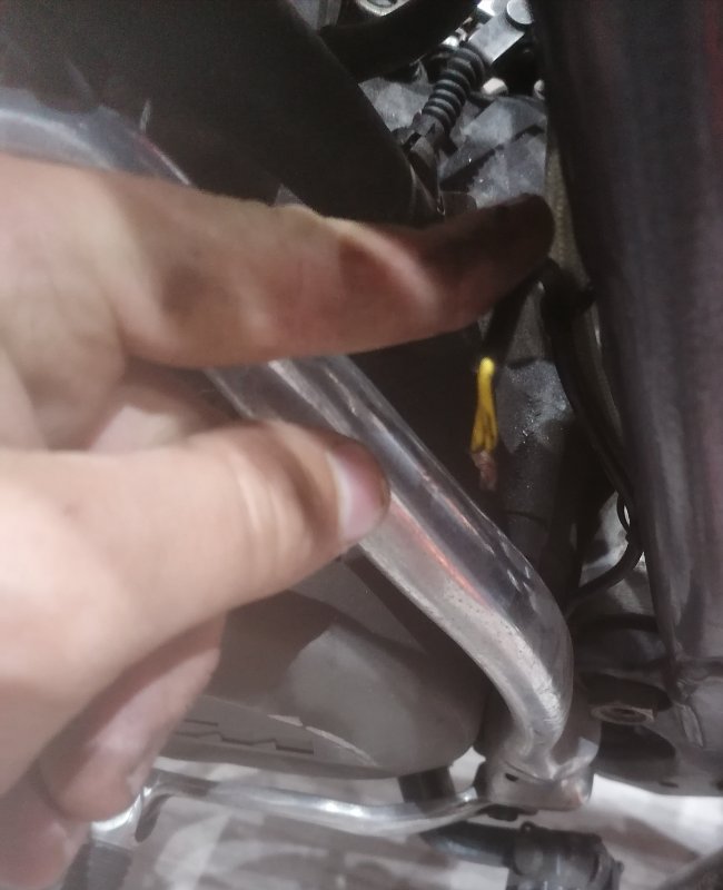

Thanks for replys, basically i had the 660/640 rear rallye tanks In which I intended to fit but to do this you also need the rallye shock as it has a remote reservoir as standard shock reservoir hits left side tank and so does the airbox so you also need to fit the 660 airbox.
All I was waiting on was a 660 rallye subframe but no luck on searches....... So I built one.
Now I need to relocate the ecu, rectifier and solonode due to fitting the 660 airbox so I decided to bolt them down under rear mudguard on the tray.
Now I need to make the cables longer hence new wire with connectors. Current connectors had a loose wire which I now found.
However I have the neutral switch wire fault now so need to either replace this or bypass it
