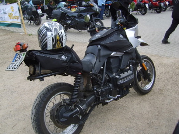

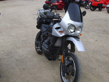

Half way to how I’d like my project to look....

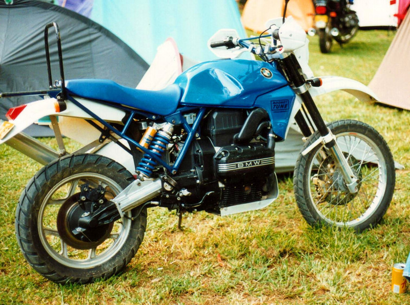

Fitted with R100GS front forks and paralever rear end - seems quite a good way to go and it has a spoked back wheel. Not sure if there is a spoked hub available that'll fit a standard K75 bevel drive.
However, the K75 is quite popular as the basis for a GS type of bike
