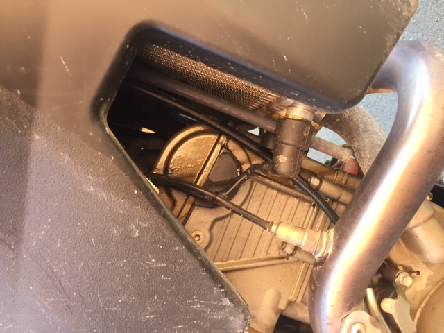

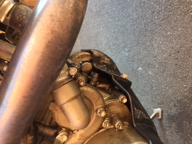

Well after a ride from Wales down to Bobs for the ABC Hill Billy weekend in East Sussex, I guess it was too much to expect the 450 to perform without fault. Arrived back home on the Sunday after riding in horrendous rain thinking that my boots were just wet from the amount of water spraying up from the surface, but no it's a flaming oil leek :pinch:
Less than 3500 miles on the clock and its pissing out from the top end somewhere but I can't be arsed looking at it, the heap,is now back in the garage over a drip tray until I return from France in November. Checked the Warranty but you can't claim direct, has to go through a dealer, nearest on is Stafford, doesn't include labour, delivery any service items etc and the final word is with CCM :pinch:

looks to me like its blowing out through the airbox ..any slight overfill will result in a the aibox getting oil from the crank breather prucucing the appearance of a leak ..odds on its that..hope so anyway (thumbs)

Steve, I hope you are right but I had ridden 550 miles from picking it up, this occurred in the last 20 or so??

looking at the pic it looks to be dripping down the side of the cam covers ??if this is so it almost certainly the airbox ..a bit of overfill and a prolonged higher speed run are the usual ingrediants for this ..
there isnt usually any payback once the oil level is low enough ..they are very fickle with oil level ..when it cold you dont want anything showing in the window at all .if you then rock the bike and see justa tiny touch at the botton of the glass its good ..goes againt your instincts but it works thatway :silly:
..when its properly warm it will show well above half on expansion ..if its showing any substantial level in the glass when cold its overfilled ...
..anyway hope that what it it is fingers crossed

A chap at the Midlands Rally had one--only since March I think--and his started leaking oil from the top somewhere--it was a warm day--but the leak only started after his ride to the rallye, the trail ride, and then a lap or two of the enduro course. If its draining from the airbox is it being filled up from the crankcase breather?--and is there not a longish tube with a squidged end that allows the bike to run in water, and then can be squeezed to drain--that would confirm where the oil was coming from?

On my g450x (basically same engine ) I can only squeeze 1050ml of oil in, any more and it pisses out of air box, you can actually here it "belch" oil in to the air box when you turn her off. :ohmy: but saying that I normally over fill by mistake, and have had no probs (thumbs) . No what you mean minky about the site glass :whistle:
