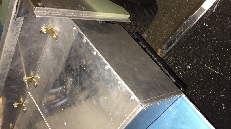

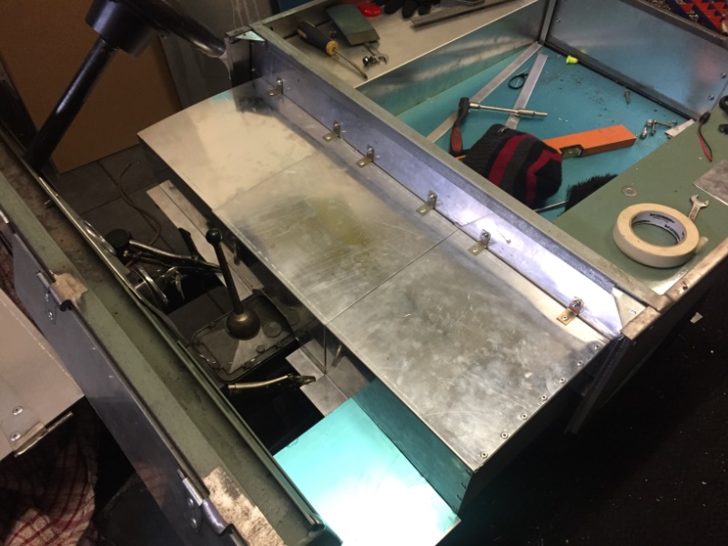

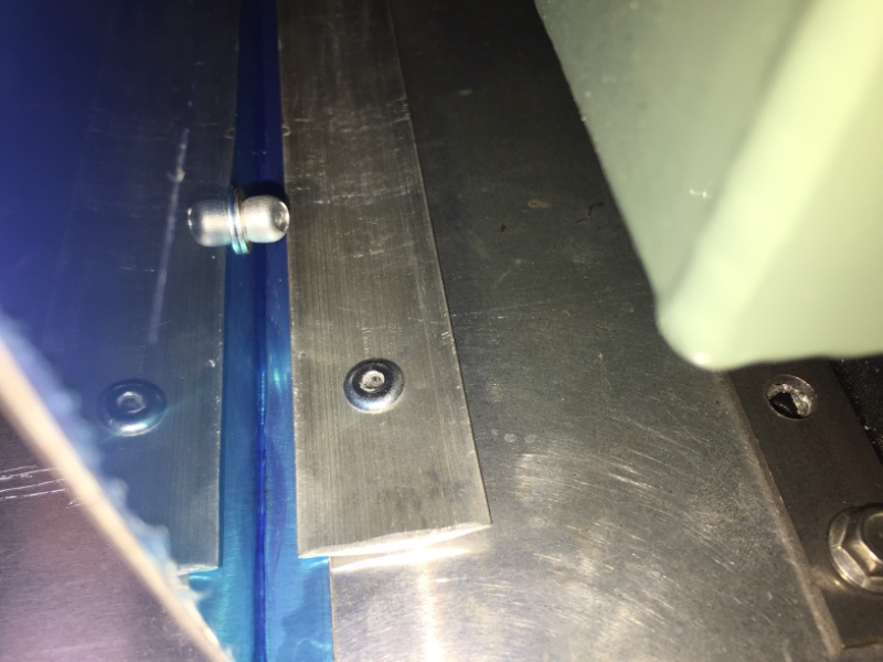

Again pure guesswork on the seat base, im just building it till it looks in proportion and looks not out of place, im copying pictures on the net but there is many variations
The seat base had to be done in 3 sections as the bend across using 1.5 mm was just to difficult. And needed a sharp angle.
Not actually gonna sit on the base to drive it but it needed to be very strong and very straight so riveted and bonded a thick alloy strip to allow the seat base back to lock in and gets tighter the more its pushed then a few clips to hold it down. It now comes out as one large section.

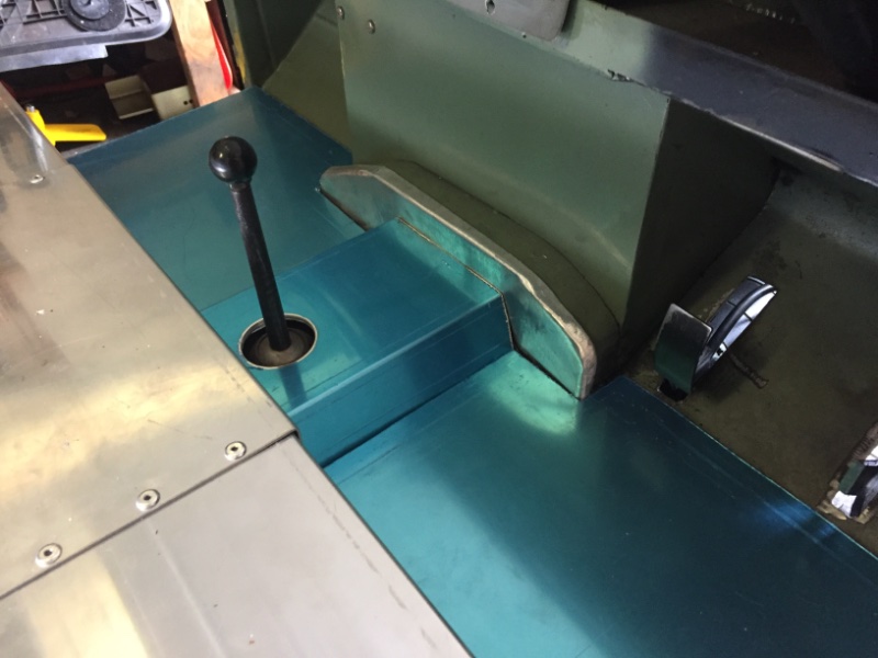

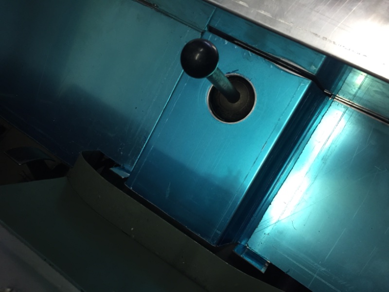

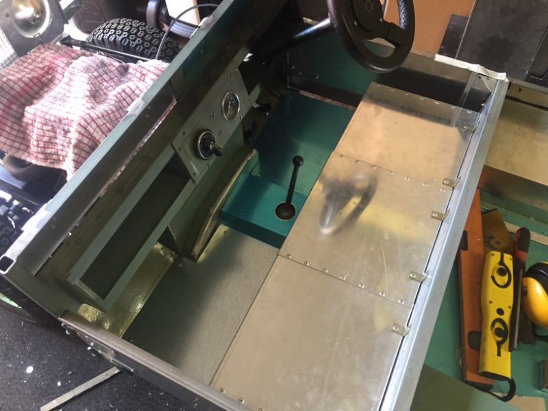

Seat base and floor nearly done, the floor panels are supported from the chassis on webbing pads and all bolt together which makes is structurally solid.
The round gearstick hole isnt right and needs to be square also i will put a fake transfer lever and 4wd knobby thing!

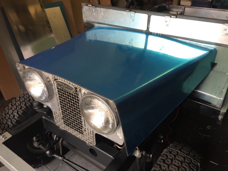

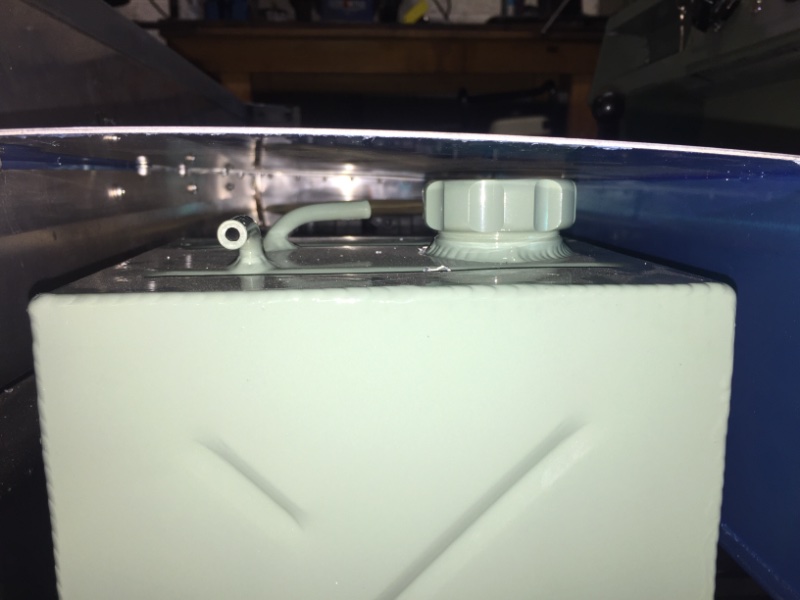

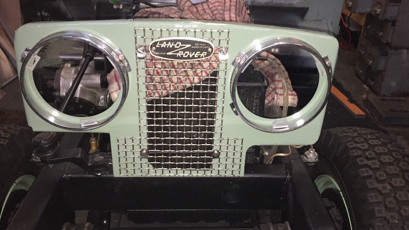

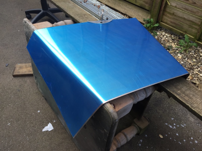

So still covid isolated in the garage and still keeping the enthusiasm going cos naff all else to do, its coming on nicely apart from dropping both headlights at 3am and totalling them
