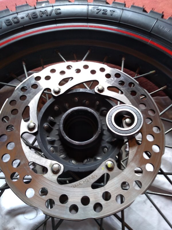

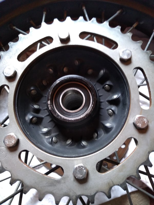

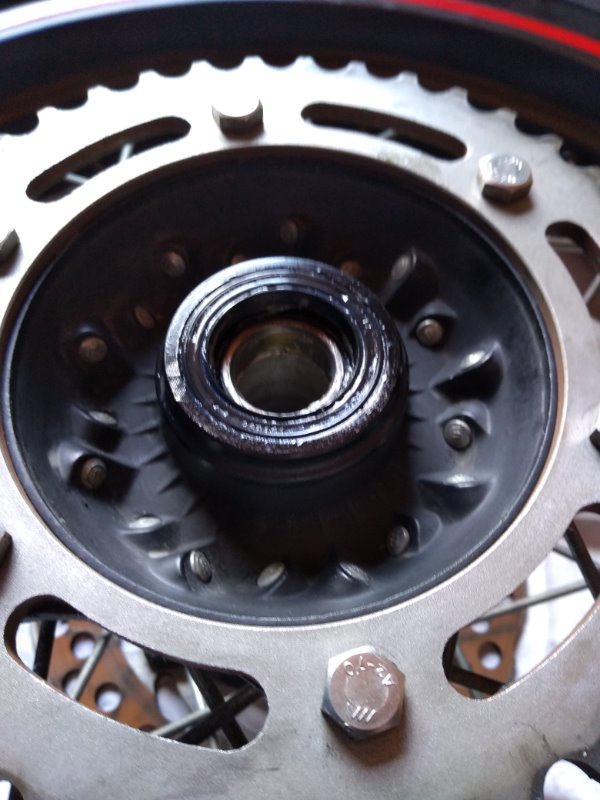

Finally got round to the rear bearings this morning, popped to Halfords to get a 33mm impact socket to drift in the bearing
Rear bearings I used were SKF 6005-2RSH and new oil seals 35x47x7 due to the originals being damaged
Straightforward job rear wheel off
remove spacers, oils seals, lever inner spacer to one side to get a visible lip on one bearing then either use a long drift punch or old socket extension bar and hammer even hits around in a circle to remove said bearing, the inner spacer will fall out then turn wheel to remove the other bearing
I did have the new bearings in the freezer for 30 mins just to assist the installation, lightly grease bearing hosing then using the 33mm impact socket hammer evenly the new bearing in listening for the sound to change that denotes now seated...……..turn over wheel ensuing inner spacer is placed in hub and install second bearing, just before seating line up inner spacer
Once bearing are in lightly grease the remaing bearing housing and the new oil seals and push home, new seals may need a rubber hammer to gently persuade then to go in ........clean up then re install wheel......lovely then put kettle on

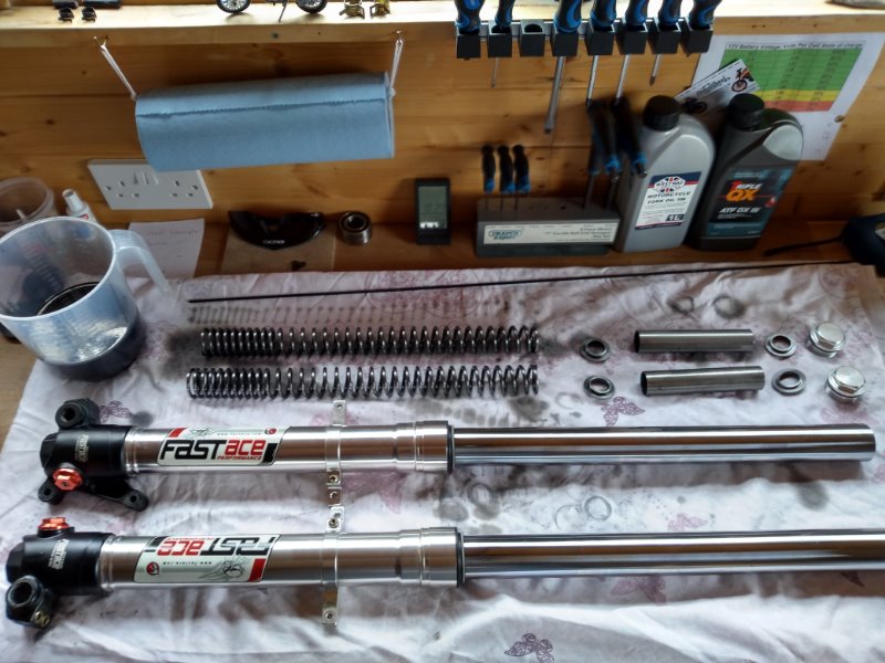

and today I be mostly fork oiling...……..
I did the fork oil way back in December 2017 , I had the customary knocking and what came out then was horrible, black slurry which stunk. I measured each fork oil volume that came out and had 460ml in each. Based on some research this was assumed too much so went for 360ml which just covered the top of the damper. The result was great, smoother ride no knocking...…... result...….
as I have recently noticed a decline in the smoothness of the forks after around 3000 miles I would do another fork service
again today what came out was grim and this time I did a bit more of a clean and flush, again went for my new baseline of 360ml each leg using standard 5w fork oil. I think as I did a more thorough clean and drain 360ml in the right fork didn't quite cover the damper so have used 370ml in the left and 380ml in the right and will report back once tested
