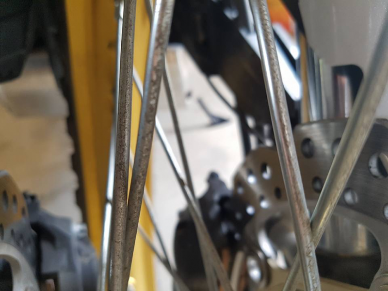

Hi this was on the Africa twin forum, the bike has covered 900kms , Honda Australia said its down to weir and tear :whistle:

That's a build-up of metalic dust from the brake pads. If you don't wipe it off, it digs into the spokes and makes them go rusty. My KTM 950 looks just the same.
Some heavy trucks have polished, unlacquered forged aluminium wheels. When disc brakes first appeared on trucks, the wheels suffered from pitting which was down to hot metalic particles being abraded off the brakes and sticking to the wheels.
Alcoa now do a 'Durabrite' coating on their truck wheels.

moto al wrote:Hi this was on the Africa twin forum, the bike has covered 900kms , Honda Australia said its down to weir and tear :whistle:
As it`s down to WEIR and tear I presume it has been ridden through water? :side:

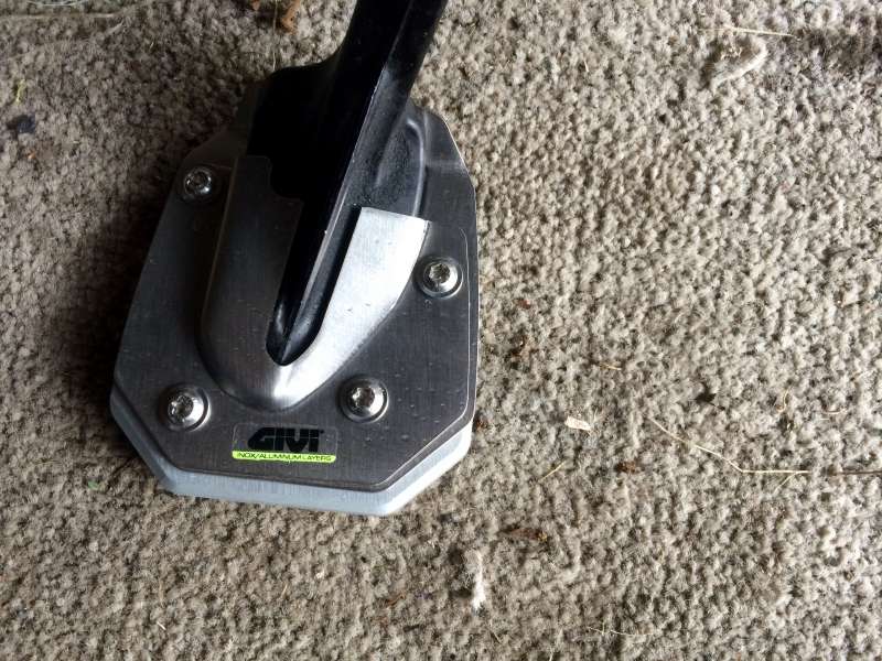

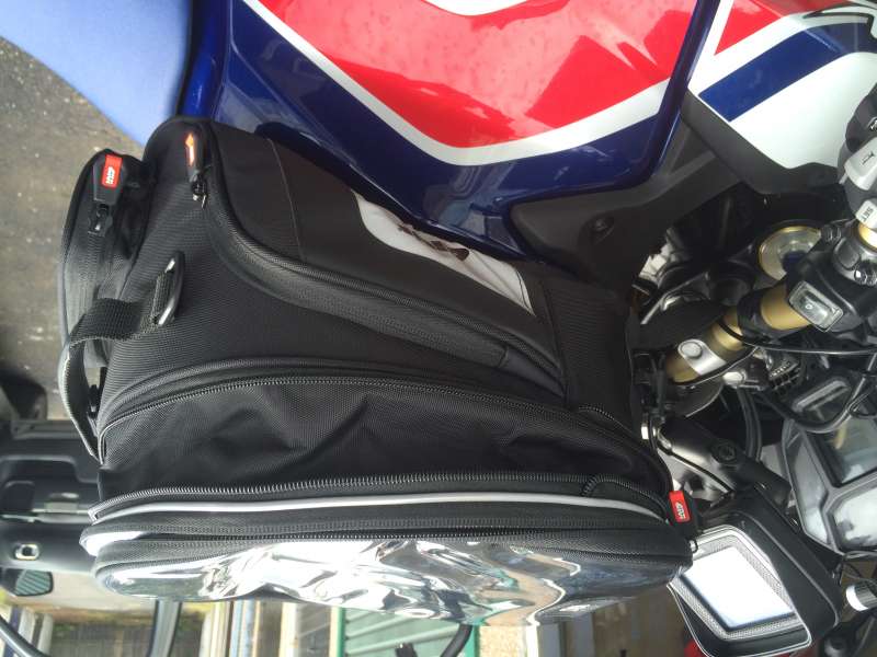

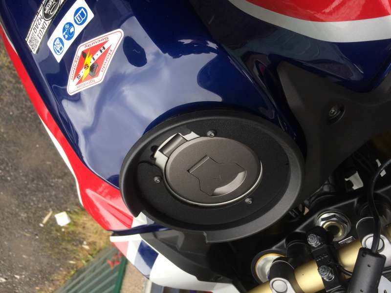

Today I fitted a givi quick release tankbag , has anyone use one ,and any comments . I also fitted a big foot ,with the help of Franco ,unfortunately you can't use a paddock stand due to the design of the swinging arm.
Mine looked like that after the first ride from the dealers ( roughly 20 miles ) , washed it and the next day I have noticed the damaged plating on one side of the spokes , all I know is that some bikes suffer from the same issue , some don't , stainless steel spokes don't suffer from cheap plating issues . ;)
Iv been told Honda know theirs an issue , and with 2 year warranty I'm not really pushing for new wheels at present . Cheers Al . And it's still a great bike.
