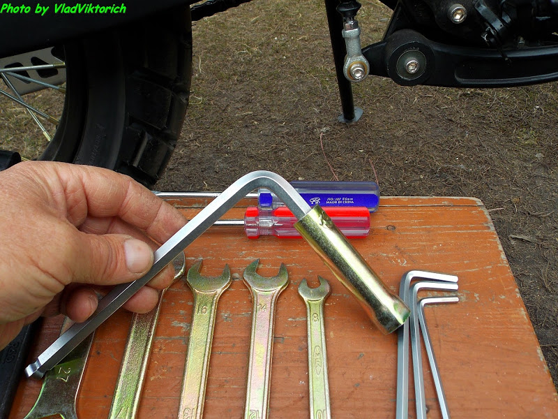

Hi Phil, be good to here if you have found out anything more on route cause of the mystery smoke. .........The spark plug is a real pain to remove, it is possible with the kit that comes with the bike so not sure where that has gone (see pic), you would need to remove the plastic crash pads either side of lower tank and their respective metal frame to get access, even then just getting the HT lead off is a real test of your patience......another thought on the side stand and your bike falling over i assume having read through this thread your aware the side stand was shortened and the bike lowered ? if your anywhere near the south coast happy to lend you the plug spanner
