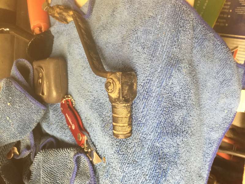

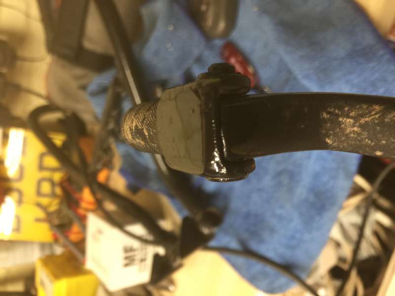

Thought it would be of interest to those that take there bike off road, the gear lever has two sharp corner, it bends if you drop the bike and hits the side casing and chips the casing, the casings are thin and you may end up loosing some oil till you repair it,
I did exactly that so I've taken the corners off with a grinder and painted the gear lever

So much like the DRZ,maybe you could install the protection plates too?

Grahamkevinbutler wrote:Thought it would be of interest to those that take there bike off road, the gear lever has two sharp corner, it bends if you drop the bike and hits the side casing and chips the casing, the casings are thin and you may end up loosing some oil till you repair it,
Good shout, will have a go at mine at the weekend

Andi_Archer wrote:So much like the DRZ,maybe you could install the protection plates too?
http://www.wheelingcyclesupply.com/shop ... o-pack/519
Yes that would also do the trick Andi
