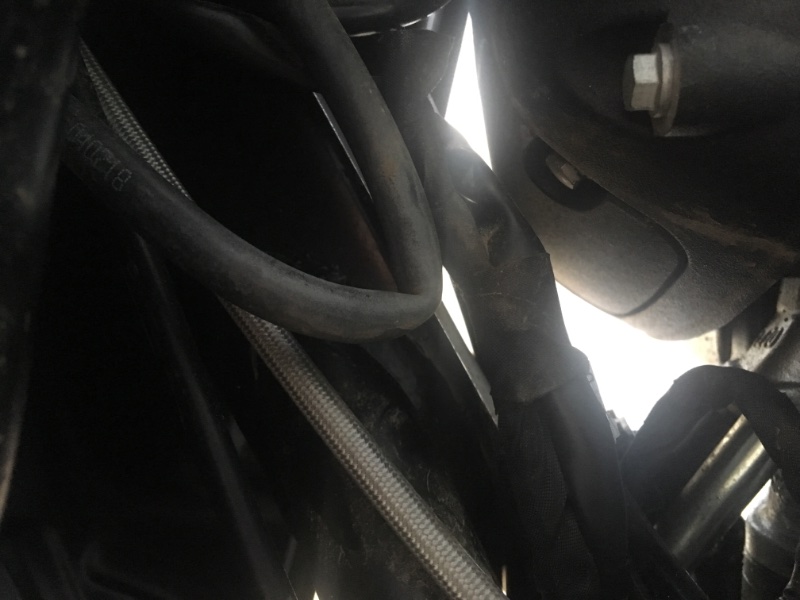

Had a morning riding mine today and a couple of niggles, clocks slightly misted but nothing too problematic. But one thing that did bother me was a couple of times it cut out whilst coming to a stop and then once when I pulled away. Bit disconcerting but only 500 miles on it so far, so maybe it needs to bed in a bit? C

Worth getting checked out the cutting out mine didn't have that. The clocks were only minor for me then got really bad, worth getting them changed as there is a warranty. I put an iridium plug on mine, made it slightly more responsive at low revs but much better on startup from cold. Other than that hope you had a great ride today

Godspeed wrote: Sun Mar 24, 2019 10:21 pm Had a morning riding mine today and a couple of niggles, clocks slightly misted but nothing too problematic. But one thing that did bother me was a couple of times it cut out whilst coming to a stop and then once when I pulled away. Bit disconcerting but only 500 miles on it so far, so maybe it needs to bed in a bit? C
Do you run yours on Premium octane fuel? They tend to run smoother on premium fuel.
Also being air-cooled it is a good thing to let them warm up for a minute or 2 in the morning as they tend to run a bit lean and needs a bit more fuel when they are cold.
Could also be that your idling speed is adjusted a tad slow. Might need to be adjusted up a bit. The info should be in your owner's manual.

It’s a bit strange as one time I was coming to a junction and even though it had been warmed up ok and the idle was good it suddenly cut out and then almost immediately re-engaged, almost like a mini bump start. I’ll keep an eye on it, I’ve not long had it so plenty of warranty time left.
Appreciate your thoughts though, thanks

Think I may have found the cause... saw something from an Indian blogger who found that the evap tubing gets kinked under the tank....
Lo, I give you a kinky tube 😂
