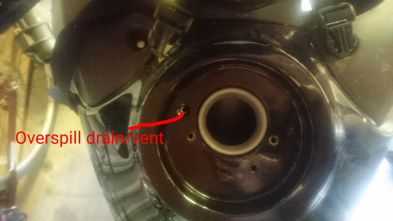

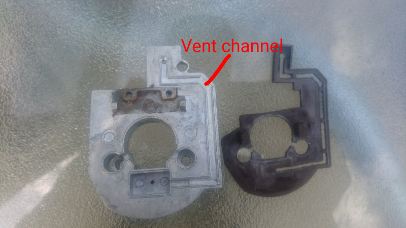

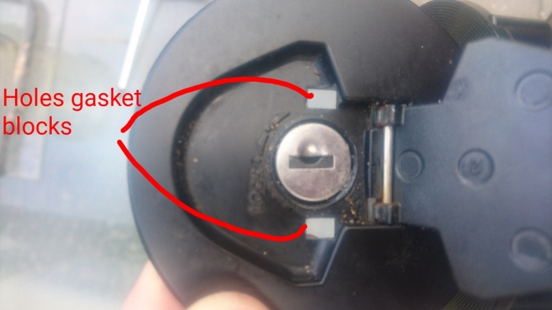

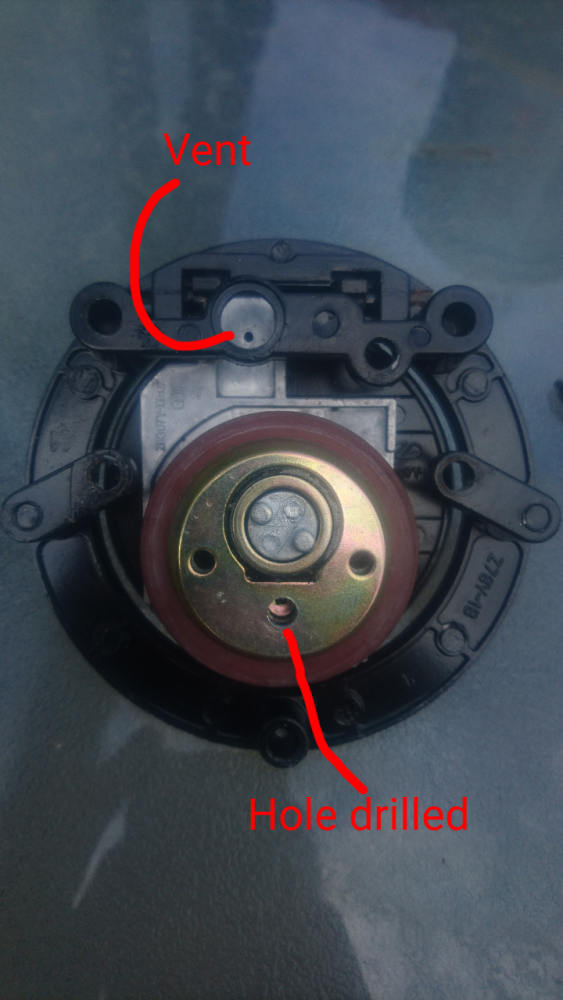

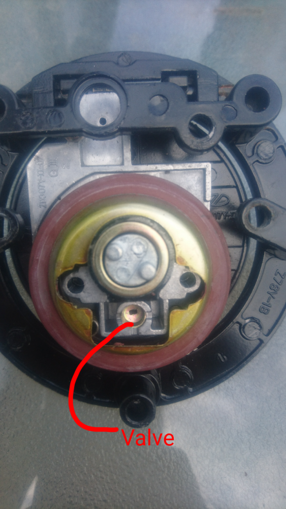

Hi all, not sure if the fueling issue is electronic or something else but here's some pics of what I did to my fuel cap which seemed to improve it. The brass plate blocked off the valve in the cap which I believe allows the tank to vent into the overspill space at the top of the tank and out of the drains tube, by the channel inside the cap assembly. I think if you remove the gasket it will allow water/ debris into the top of the tank space potentially causing issues in the future. Could be wrong but works for me. Cheers.

Normaly a vacum loc is just that so speed and fuel level wont effect it...also hot sunny weather is a vacum problem causer normally..my money is.on a bad desigh in fueling either ecu or a sensor somewhere...has anyone had the problem changed by altitude?..injection normally renders altitude asnagaist carb fueling...
