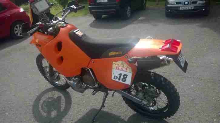

So I am waiting for the exhaust connector adaptors to arrive. I have a 50mm pipe I will cut to required size as connect.
See the exhaust that was fitted compared to the proposed option.
I just roughly sat parts on to get a idea nothing is bolted together
Re: KTM 640 Adventure Rally Build
Posted: Fri Jun 12, 2020 7:23 pm
by WesleyDRZ400
What do you guys think?
To long should I attempt to cut the can down abit or its OK.
It's just a rough idea of location as will cut the pipe with bend to fit with joint connections
The connecting pipe is long which I need to cut so if I cut the silencer down in size it will still be high up which looks better I think

Re. the exhaust, which is the only part I feel in any way qualified to comment on having fitted hundreds of slip ons and full systems to race bikes and sports bikes... Is that really the correct can from Akra for a KTM640? It looks huge, and looks to me more like the one they used to make in the 2000s for R1s, Fireblades, GSXR1000 etc. You could cut it down, but maybe something slim and much shorter like Racefit do would suit the bike better?
