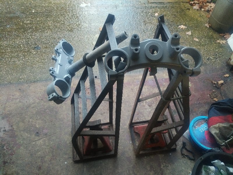

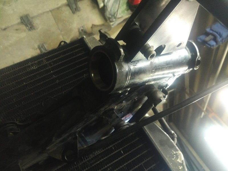

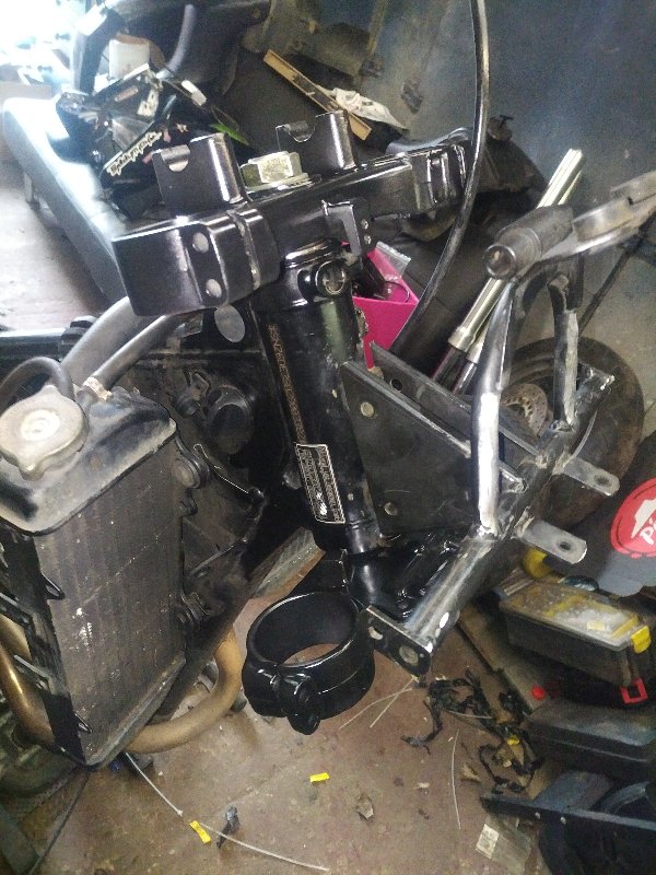

It's finally got to the time were I see if the theroy I read online will work I have had the forks a while been waiting on parts bearings etc while doing a few other bits and bobs and I got to say I've been a little sceptical whether they were gonna fit and work aswell as they put online but the tapered bearings kit come from all balls racing and the cups when straight in a treat :) bottom one was the hardest to get in think it was just the thickness of the powder coat on the frame rubber mallet though and in it went
the top went in no problem at all and fits a treat...
I have noticed though my garage floor is getting all wet due to leaking in so that's going to have to get sorted along the way aswell ....

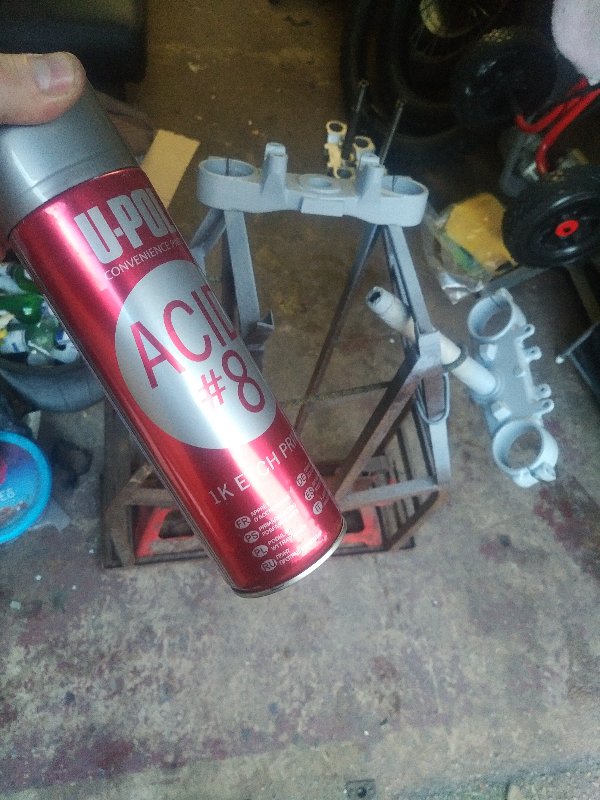

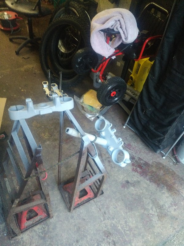

Decide to spray the yokes with a acid 8 primer and it has held great couldn't decide whether to go with a chrome paint and then candy apple or anodised red colour but in the end decided on black the thought behind it was that the bike is gonna be a rally bike used for off road so black is easier to touch up and sort back out were as the red I like as I really like the look of the ccm gp450 rs colour scheme but it didn't seem logical to me so black was the way forward

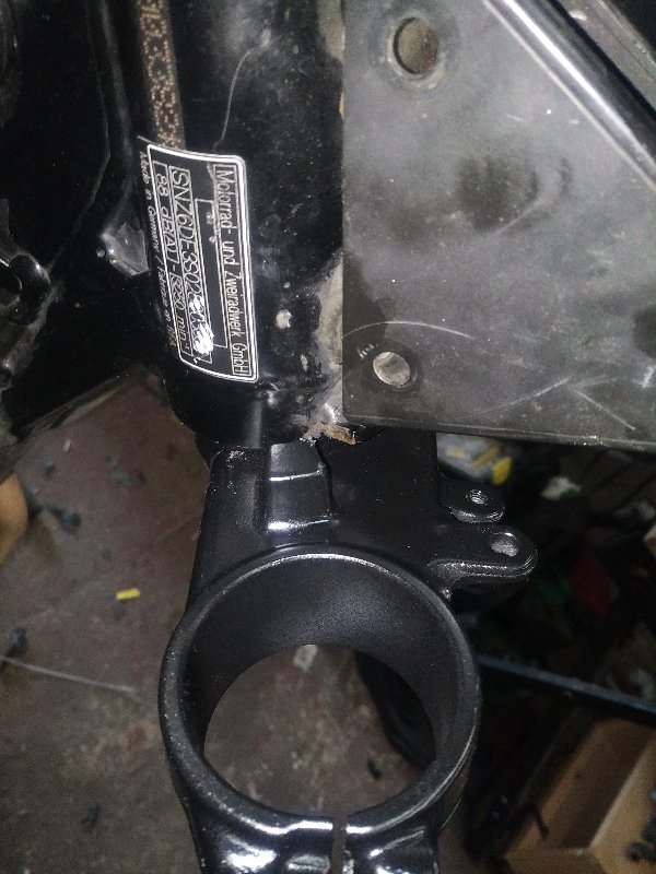

Well I most say iam a happy bunny got my all balls bearings through the post and the paint in black as just gone the 48 hrs hardening process so it was the time of truth I've been wondering for weeks whether or not the yokes were gou g to fit this build and wondering whether I'd wasted the money but I gotta say they were a great fit a 3 mm spacer was needed from simply bearings and everything else fit a treat
the steering stop works perfect and sits brilliantly like it was mentioned to be there
my only down fall is the nut that sits under the top yoke is a c spanner nut that someone as smashed a good few times with a hammer and screwdriver by looks of it and I've searched high and low over then Internet and can't find it anywhere eBay sells the top nut but not the one underneath everywhere I have been and looked shows the peice but doesn't have it in stock so iam a bit lost on finding one at minute the only ones I found were second hand and just seemed the same battered and mangled ....

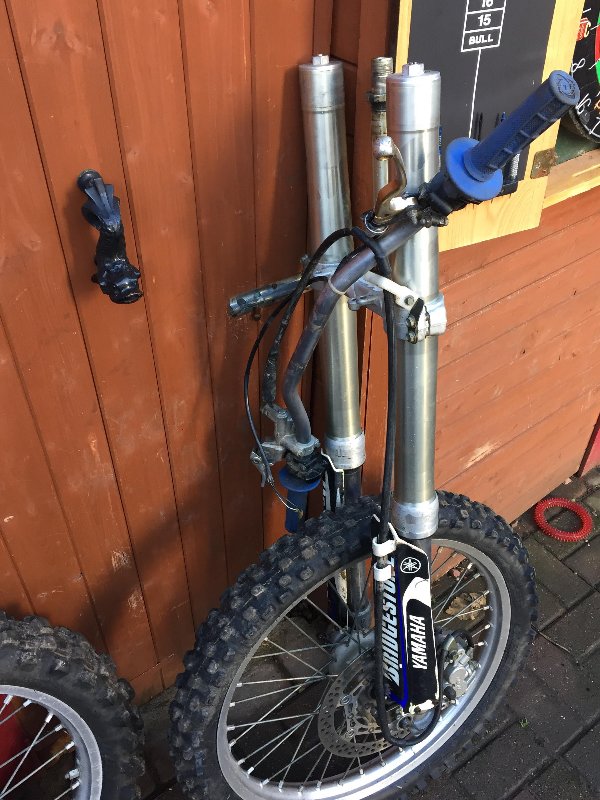

Well it's near Christmas and I should really be thinking about Christmas but I managed to find myself another front end the same for 200 notes and it's a full one :) so I just had to buy I don't think it was a bad deal spare forks front wheel calipers brakes clutch yokes plastics etc
now I can try it out before all my suspension is redone and anodised etc .. And I'll have a set of spare forks yokes etc which will come in handy also my levers will now be wr /yzf levers so no problem. Anymore with trying to find mz spares as I can get packs of 3 levers for cheap enough for the yz levers just need to source an ebc oversized disc and bracket to try to compensate for the braking while on road hope it will be a compromise and at least be 50/50 if not better on the road ...
