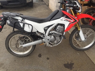

Spadger wrote:Hi , Crofty hopefully your still keeping tabs on this thread , could you tell me what pannier frames you have on your bike , I'm going to be needing a couple of sets for some soft luggage , cheers john
I'm sure I asked crofty a while back the frames are based on Dirt-bags frames which I have his were made by a local blacksmith I couldn't find someone local to make some

Spadger have sent you a pm about the pannier frames, basically a copy of dirtbagz http://dbzproducts.com/fs/index.htm Nice picture Drumbrakes, mine climbed mountains as well.

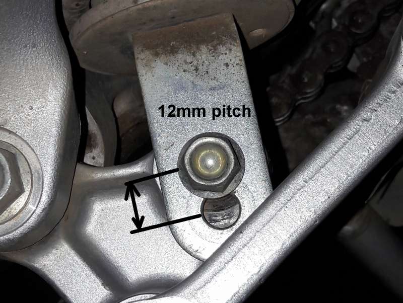

If you want to lower your CRF250L
drill 10mm at a pitch of 12mm
this will lower it 50mm's.
You can dial the rear spring to the softest.
Our lady handels it perfectly.
Be carefull wenn you pitch 3/4" - 19mm you get i kind of a low rider i.m.o.
