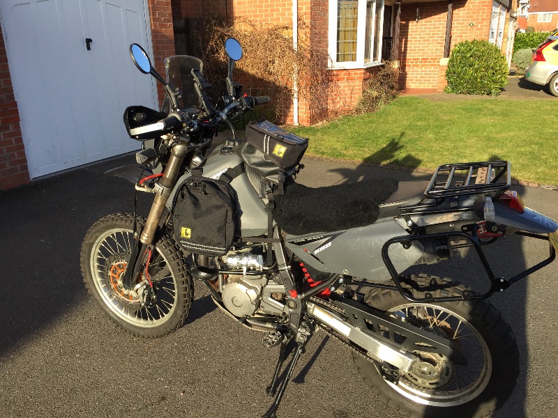

So I was thinking I am just about done and ready for Morocco except would love to use my heated gloves for the return trip in Oct, was 0 deg last year. So maybe a new Mofet reg/rec and maybe an upgraded stator. the PO said that the NSU mod had been done..... How? B?*&%? looks like Im gonna have to strip it back down and check. Then maybe have to send for more from Procycle (panniers were 3 weeks in UK customs).
I now have a set of the wolfman pannier frames to sell, will post pictures soon as away at moment. Anyone interested drop me a line.

Good pic. Looks really up and ready to go. Have a great trip.BobH wrote: ↑Sun Feb 18, 2018 4:56 pm IMG_0747.JPG

Looks the bollox Bob , i'm toying with the idea of some usd forks , got a set of husky ones in the shed with wheel ,caliper and the works just need to size up the bareings.
If the winds blowing the right way i'll see you in Maroc

That looks like a well fettled DR Bob !BobH wrote: ↑Sun Feb 18, 2018 4:56 pm IMG_0747.JPG
