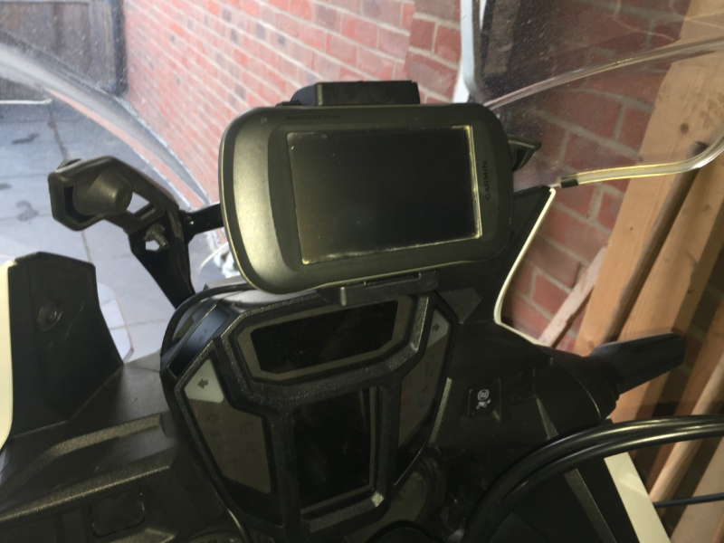

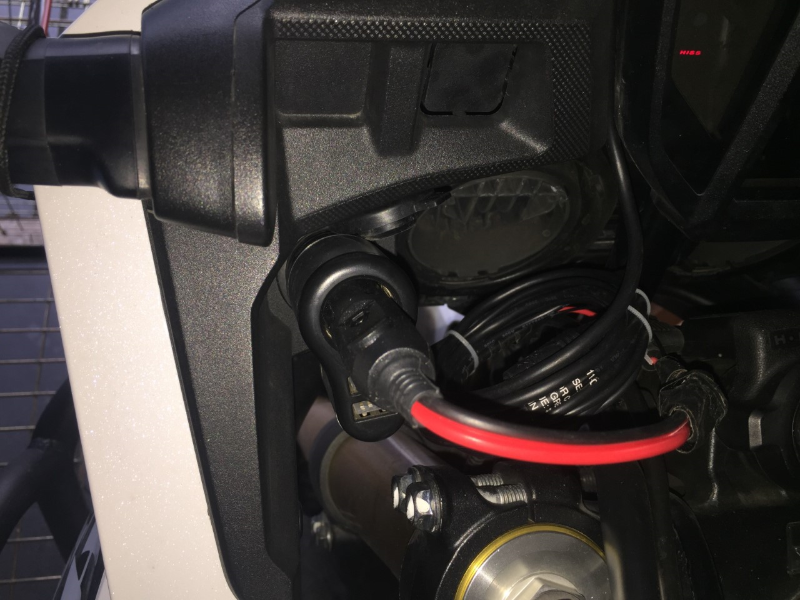

Re: Garmin Rugged powered mount with 12v cigar plug
This is how the set up looks now! in pic 2 you can see the wire from the mount rolled up and cable tied, I left this so that if I do make the setup permanent I can use all of the wire to reach the battery
