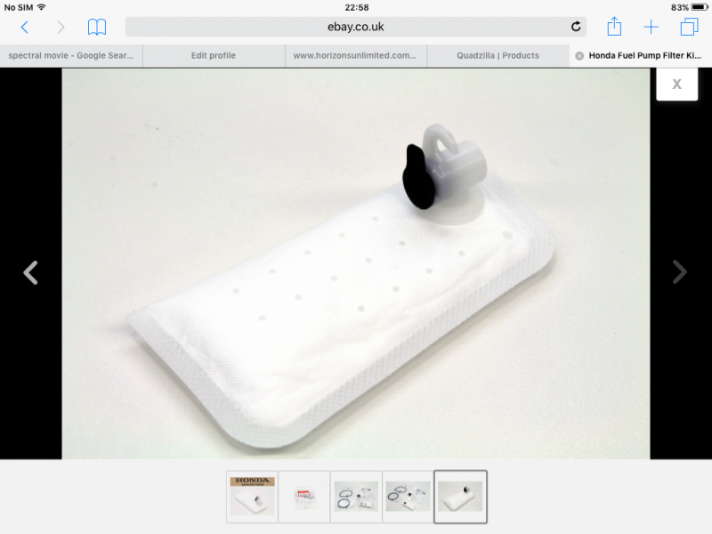

I've had a look around to see what may fit as a spare, other than getting your hands on one from quodzilla the one that looks as close as you are going to get is a filter off a crf250 or the crf450, problem is they are about £48 plus post

This one?
Filter kit, fuel 06160-men-a31 £30
http://www.ebay.co.uk/itm/honda-crf-250 ... SwIgNXjTnA

'one that looks as close as you are going to get is a filter off a crf250 or the crf450'
'This one?
www.ebay.co.uk/itm/honda-crf-250-450-fu ... SwIgNXjTnA'
Thanks Graham & Andi, that looks similar to the wk one, as it seems to 'hug' the pump a lot closer with no gaps, though a different mounting style used ...
Update-
CRF style filter hole Diameter is (according to aliexpress search) 7.21mm but WK needs to be 11mm !
