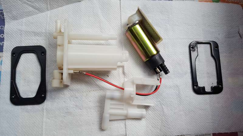

' .. take a picture or two of the fuel pump and let us know if its simple to remove'
Sure, no problem, I removed and emptied the petrol tank and then the fuel pump assembly was easy to remove as only held in by four screws (wk pump still works fine but gonna keep it as a spare and fit another to know I can.)
I was then able to unclip and separate the plastic housing around the pump itself
Here is a close up of the filter
Based on the dimensions it appears to be a common size 30mm OD pump as used by Yam wr250r, ktm 690 etc. I've ordered a Japanese spec replacement pump and should be with me end of the week, if it fits/works I'll update post with details.

Hi Glenn, brilliant thanks for the pictures, helps alot. I had a lot of bits in my tank when i first got the bike and did a few tank drains to clear it out but wondered if the filter would have taken a hit so was planning to pull the pump and clean it. Hope it seals ok when re installed. I have an interesting thing with my 400 trail after starting on a warm engine it runs for a bit then stops, may do this once or twice until temp up and ticks over perfectly, didnt know if this had anything to do with fuel trying to get through the pump ?....or just a WK thing

Are the filters seperate parts on those pumps as it may be handy to have a spare?

'Are the filters seperate parts on those pumps as it may be handy to have a spare?'
My newly ordered pump comes with three different style filters loose, and you attach the suitable one for your bike. Unsure if you can buy filters on their own ...
