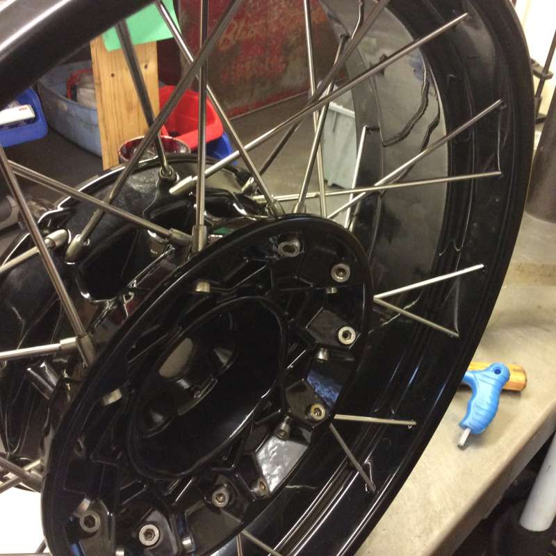

Just nip up the spokes up,
As said in other posts x spokes are a bit different to traditional wheels,
The runout tolerance is quite a lot , but the idea when building them is to get them running true as you torque the spokes up,if the rim is bent ,its bent ! You will not pull it true like a cycle wheel.
The rim is just too tough (thumbs)
Here's some I built earlier B)

very nice finish, that how i want my bm alloy rims to look in the black

very very nice...
