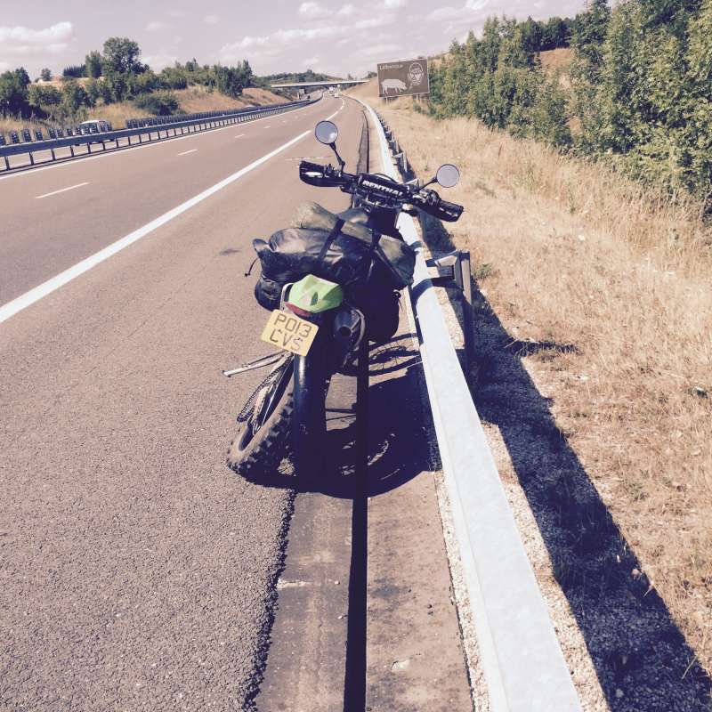

I was doing a steady 80 mph in 35 deg heat for 3 hours on a motorway in The South of France on Mousses........
Sometimes the know-it-all bloke in the pub or the internet naysayers are right!
The mousse expanded and exploded off the rim, taking the Tyre off together with the chain.
It wasn't a great day.
