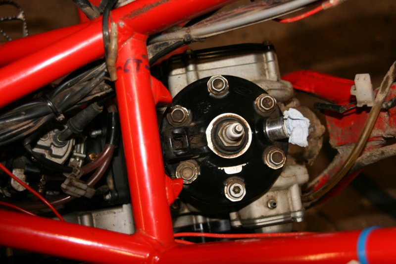

With the bike back home, I stripped off the bodywork to facilitate removing the engine....and discovered something rather sinister.
One of the inlet manifold bolts had been replaced with an Allen-style security bolt...the kind with a pin in the middle so you can't use a standard Allen key to remove it.
Never mind...I have a faithful mini-mole wrench owned since the 1970s that made short work of it.
Then I noticed that one of the cylinder-head bolts had been replaced with a similar fastener.
Naughty...it's like someone who has worked on the bike previously has tried to lock up the engine so only they can work on it.

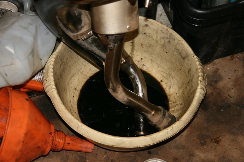

Here's the oil I drained from the exhaust

And here's a view of the head, the the 'naughty' bolt at about 6 o'clock
Why would you do that?

My first thought was that the mains have gone, but I read elsewhere that the crankshaft seal often fails all on its own at about 200 hours.
My bike failed at 206 hours.

What has apparently happened with my bike is a failure of the seal on the crankshaft that sits between the crankcase and the gearbox. When the piston is rising on the compression stroke, it creates a low-pressure area in the crankcase (drawing in the fuel/oil/air mix through the carb). But with a faulty seal, it will also pull in oil from the gearbox.
When the piston falls on the combustion stroke, the oil in the crankcase is forced into the combustion chamber, and when the exhaust port is exposed it gets squirted out into the exhaust as the piston rises again.
