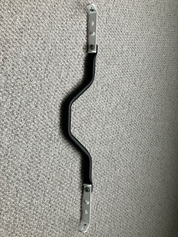

Getting a bracket welded up for the pannier rack on the PCX125….. and yes that is two brackets from a set of blinds.
I do wish I could weld, but I feel like the cost and space might be a bit too much

Re: Go Big and Ride Small
Got the bracket welded and then fixed up my pannier system and took it for a ride. With the panniers on it makes it just a little wider than the front end so I’m going to need to remember that when filtering.

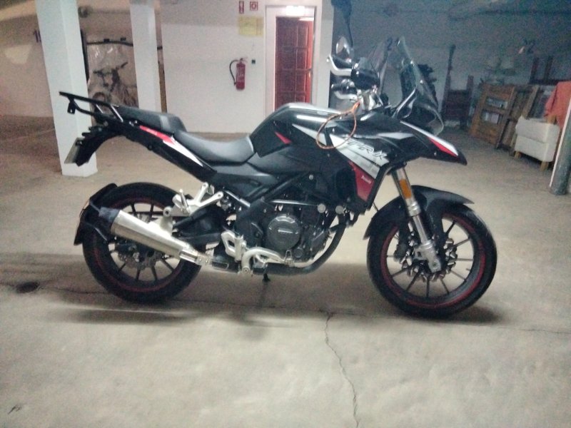

Good bye to Benelli TRK 251
I have mentioned parts of these before. But here is the summary and the end
I wanted a small travel bike with good luggage capacity (Alu boxes).
On road bike for twisty mountain roads.
The story about this bike was far from what I had hoped.
Functionality is perfect.
Nice and easy to ride.
Light
And
I could get a set of Aluminum panniers to turn it into a perfect touring bike.
It ticked all the boxes n my wish list.
If it was reliable. I would be vary happy.
But
1) One problem was with the ignition. That the bike stopped when it was raining stopped my trip tp Picos de Europa and Pyrenees.
I fixed the problem with NGK parts. Real rubber instead of broken plastic + a lot of high temp silicon.
I also found a small drain channel from the side of the spark plug. That should drain water, if the seals did not work.
That I cleaned up.
So problem was solved. But the time window for Picos was gone.
And should a bike not be rain proof ??
=> South America tour came /Himalayan)
Back in Portugal I started to prepare for a tour in Andalusia.
But I got a fuel leakage on the Benelli.
From a canister, that shall collect fuel vapor. When engine is not running.
But it was not vapor. It is fuel dropping. Filling the container and... Engine runs rich. Burning extra fuel instead of some vapor
I have fixed that with just plugging the house. And not use this environment feature.
So now the bike is running well again.
Happy days.
But two stopping faults in 6 000 km.
But even more important. When fixing these faults. I have seen the type och components used, how they are connected and the general quality level. And I do not feel confident with this bike. Maybe it is all in my head, not with the bike
So enough is enough. I have lost thrust in this bike.
And today it will be sold.
My knees and the health care system will decide when/if I buy a new travel bike.
Probably a RE Himalayan
(I did 31 00 km on mine, My friends have done 40 000 , 15 0000 and 15 000 km. Reliable)
I have a Suzuki DL 650 XT in Sweden for using during summers
Keep riding those small bikes. Small is better.
