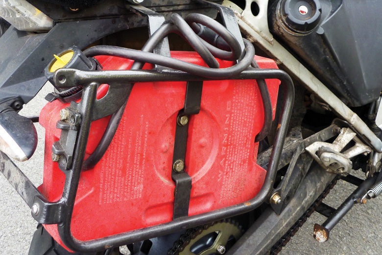

Unlike sub-seat GS800s (and the Dutch Xtank for a G650X which I had) I assumed that was not possible without pumps because it's an upward or at least horizontal syphon to the fuel pump on the conventionally positioned main tank.
If you've never used one, this pump-free seamless syphon idea is ingeniously simple: the sub tank gets drained then the AT tank.
Fit and forget: no switches, no taps, no pumps, no nothing - just fill both normally when the need arises.
If you watch the last bit of the 40-minute AT Camel installation video, the process is explained:
https://youtu.be/Aytg0bhx0e4?t=1916
The key is blocking the breather vent in the AT tank's filler cap to create the vacuum needed to draw from the sub tank once you plug the Camel fuel feed into the AT fuel pump's breather port.
The thing is, this principle will work with any suitable side-mounted/behind the rack container like a knock-off Rotopax, not just a nicely molded £350 + duties Camel tank.
See picture below - not actually plumbed in as suggested above, but you get the idea of the good use of dead space.
Swingarm/chain arc can be the only issue.
It's a bodge I'd like to try on one of my project bikes one time.
