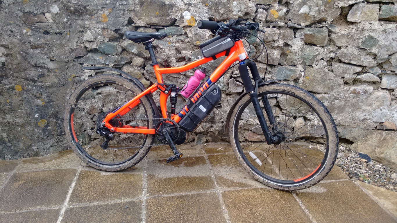

Post by Bart1 »
Just over year ago I dipped my toe into the E-mtb world with a 250w Bafang kit onto my old Canondale hardtail, it worked well enough on roads and smooth trails but was less good on bumpier trails/bridleways, so after a bit of research I found a unwanted mtb Xmas present for a bargain price and transferred the Bafang kit over. It has been brillaint, gives a very easy 60+ mile range and rides virtually like the unkitted bike.
Over the year I've added a better quality and slightly smaller chainring, a gear sensor to momentarily cut power when changing gear, fork seal savers, modded some mudguards that actually work, a better seat and some Schwalbe Land-cruiser 50/50 tyres. The OE knobbly tyres would puncture on every other ride, were noisy on road and suck power, these put the power down on roads and hard pack and lose little on muddy stuff.
I'll be the first to admit the bike will not be as good as something like a Specialized Levo, but it has only cost just over £1000 and is not that far behind. One day out I met a family whose son had a dedicated full suspension Emtb with a Bosch motor, we swapped bikes for a bit. Yes their bike was a bit better but they were also very impressed with the bolt on kit.
It works for me doing roads, trails, bridleways etc and has been a God send in the current situation.

I did the Bafang BBS01 crank drive a few weeks back on my old Specialized - loving it and out every day :)
The frame shape did present a challenge and I couldn't fit the conventional battery, but the seat-post mounting is working fine, and you don't notice the weight as much as expected - with full suspension and electric you tend to sit more anyway.
This bike has fairly long travel and even the seat mounting only leaves a few mm clearance at full compression. The forks also mean the front wheel goes close to the frame at full travel.
It is an absolute joy travelling at 15 or so mph average in total silence, it will be interesting to see how my enthusiasm is once I can use the motorised versions again, but this has opened up whole new riding areas and I expect I will want to continue....
